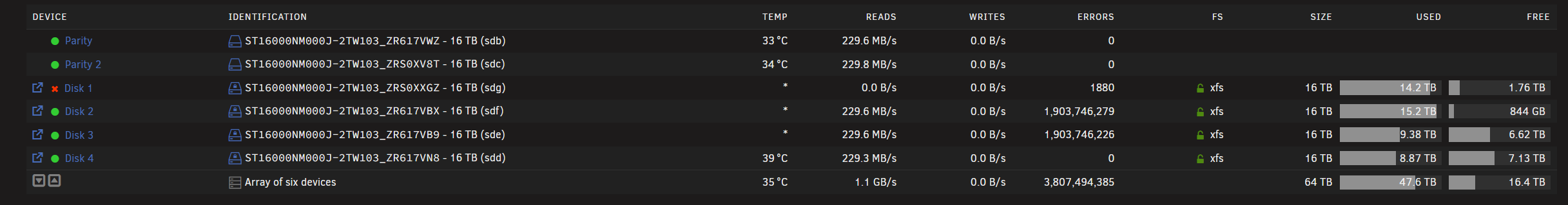

  1. Just as an update the rebuild was successful and the server is back up and parity check didnt return errors.
  2. Checked the Data on the emulated Disk 1 and it seemed to be all okay. Tested some media files and they all played back fine. Started the rebuild and it is half way done. Seems to be doing okay.
  3. Alright, I have the file integrity plugin installed. Would it be smart to let that verify the contents of the emulated disk 1 one to check if everything is in order before proceeding?
  4. So I would follow those steps and then run a parity check to correct the faulty parity data for disks 2 and 3 right?
  5. As far a i can see I have two options right now: 1. Rebuild Disk 1 onto itself assuming the parity data for that drive is good. I assume the parity data for disk 2 and 3 will be bad because the parity sync continued while they threw errors. 2. Create a new Config and rebuild parity from there.So assuming the data on the disc is fine, assuming the Controller failed in a way that took down the drives and didn't destroy data already on there. Or am I missing something?
  6. Alright here is the new Diag. I am able to see the contents of the emulated disc. jarvis-diagnostics-20260426-1143.zip
  7. I have powered off the system and swapped Mainboards to one with a known good Sata controller. I rebooted into Maintenance mode and all the drives show up fine. Also did a short smart test on drive 1 and that also came back without error, same with drive 2 and 3. Sorry i forgot the Diagnostics. Should have also taken one earlier before the reboot. I was in kinda of a frenzy/panic waking up to the notifications and wanted to get it under control. I have now attached the diag from the current boot jarvis-diagnostics-20260426-1054.zip
  8. I stopped the Parity Sync and checked all the Drives that dropped. They were all connected to the same controller. So pretty sure that is dead. I checked the smart data of the drives in a different system and they all check out fine. Is the correct step now to rebuild drive 1 onto itself? or do I take a different appraoch because of the last parity check that accumulated errors because of the lost connection to drive 2 and 3? Because theoretically i would assume the data on drive 1 is still good.
  9. The Log is full of Disk 2 and 3 Read errrors. I feel liek the Parity sync should continue
  10. Help, i just woke up and got the message that one of my Drives failed. That is during my routine parity Check. and now two of my other drives are climbing in sync errors. What do i do now?
