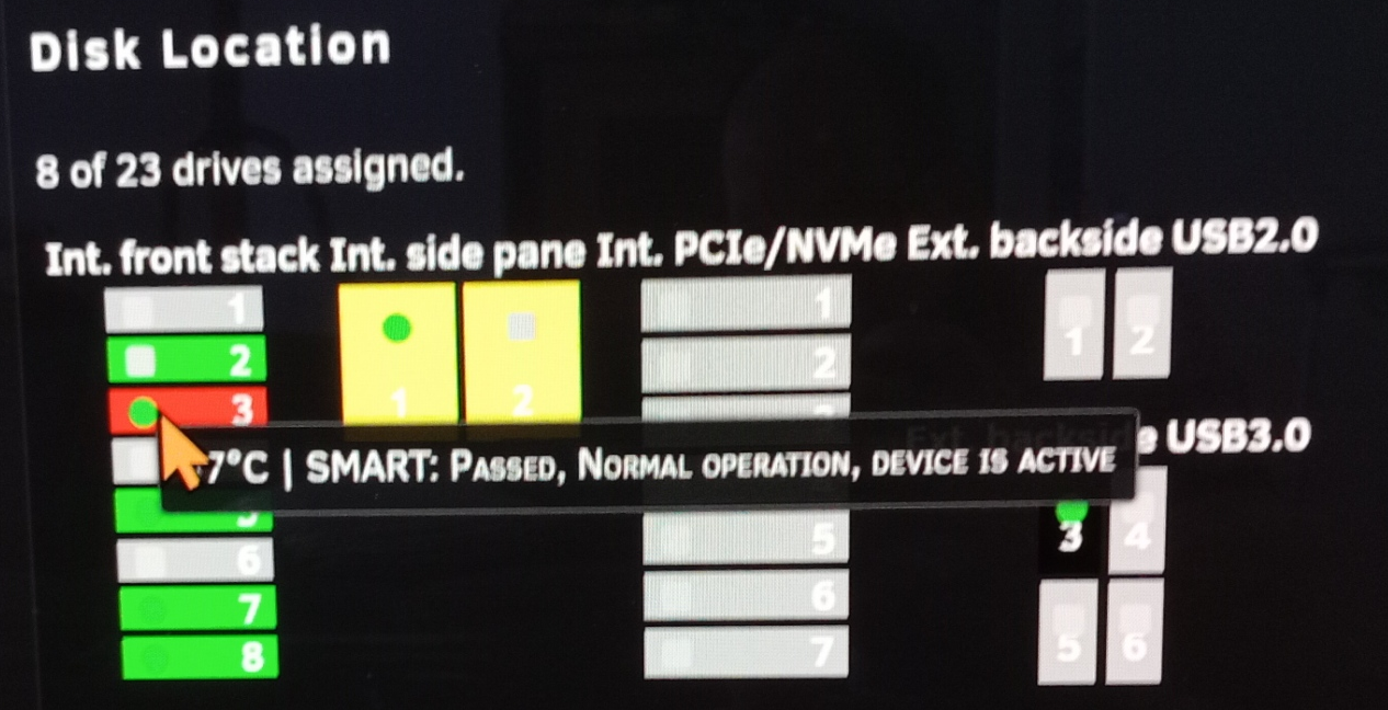

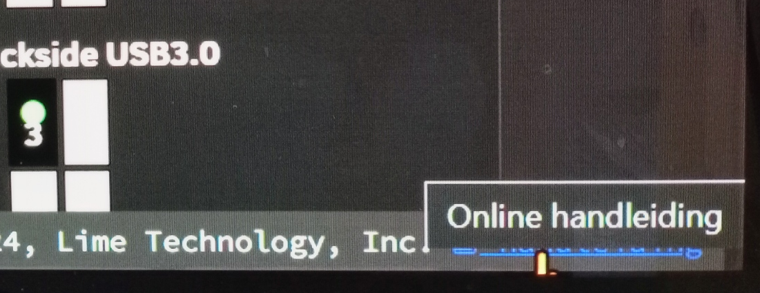

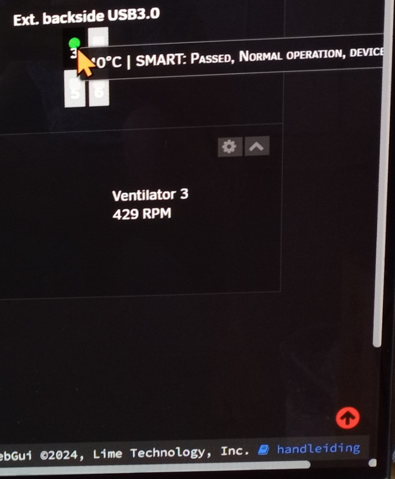

  3. Maybe I'm nitpicking, but I have grown fond of Unraid and like to contribute to make it as user-friendly as possible. I noticed the info tags being obstructed by the mouse cursor. Those little info boxes that appear when hovering. For example: I suggest placing the info tag to the upper left corner of the active cursor part, because most mouse cursors are pointing to the upper left. I also noticed the info tag (whatever it is being called) is expanding the webpage, a horizontal scrollbar appears, but the shown info is being cut off, and unreachable, like shown below: Is it possible to make the info tag respect the webpages borders and shift to stay inside the webpage window? Like:
