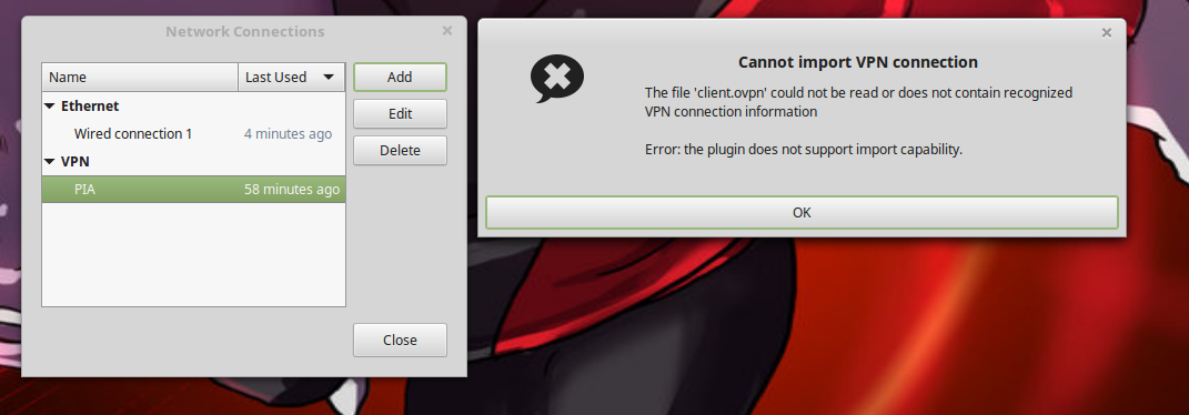

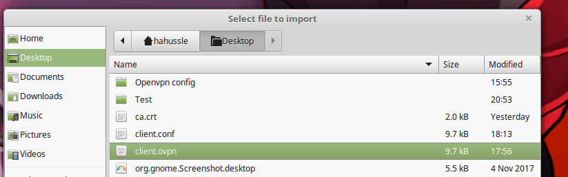

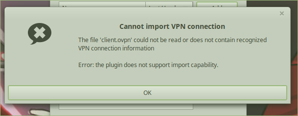

its only highlighted i tried to import my client file from my access server- [Support] Linuxserver.io - OpenVPN AS

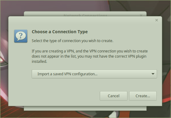

what did you do to set it up ? im fairly new to linux but not a newbie to tech ive tried getting this thing going using the network manager and it just will not connect no matter what it connects if im on windows using the openvpngui or on my android smart phone so what gives here ?- [Support] Linuxserver.io - OpenVPN AS

i am aware of that what i am trying to do is connect remotely to my openvpn server from a linux mint machine but it doesnt seem to be as easy as with windows openvpngui which is why im asking for help- [Support] Linuxserver.io - OpenVPN AS
Might be a very silly question but has anyone ever managed to get this to work on a linux OS ? i recently switched from windows to linux mint 18 and ive tried following the very simple instructions of creating a new connection and tried launching it from the terminal nothing seems to be working for me- [Support] Linuxserver.io - Ubooquity
