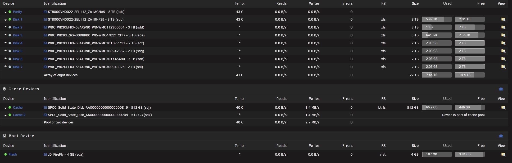

Thank you for taking the time to reply. It’s currently 2am and I have been working on the server once 9. What I thought was a software issue turned out to be a mix of hardware and software. While my system saw the 2 cache drives when I shut it all down and connected a monitor, I saw lots of errors trying to access ata12 (the second SSD) I tried a tonne of stuff but it appears the hard drive cage I used has a faulty port. I have moved the drives to a new location, new cables and did have to re-configure the second drive as cache again but it all seems to be running. I did have to goto the USB and delete the plugsin’s SQL file because it refused to see the second ssd even though Unraid is seeing it as normal. After that it’s now seeing all the drives. It doesn’t show that it’s a cache drive but rather marks it as unused. But that’ll do for now. Unraid sees them both as cache and the plugin sees them at least so I can rest easy. Thank you for all your help and suggestions.

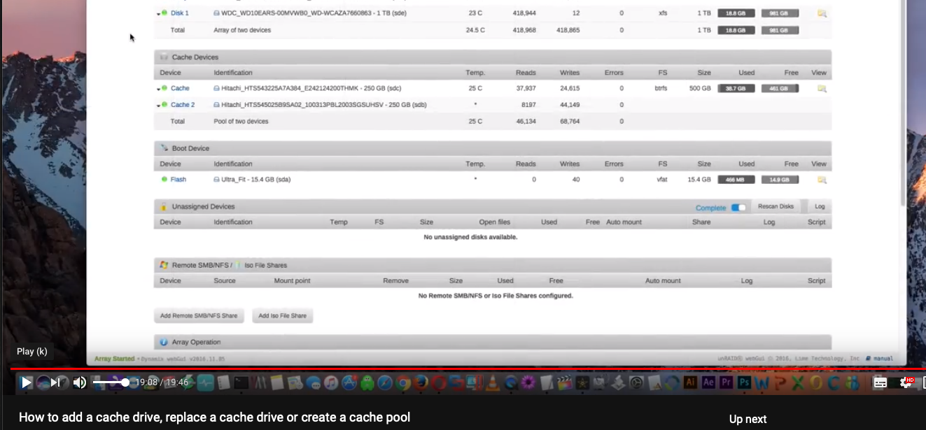

Just an update: at work right now going over spaceinvadersone's youtube video to see where I went wrong, now I didn't change the raid to stripe but I did select 'Balance' and afterwards lost the information about the second drive. this is a screen shot from his video reflecting the same missing temperature that I do so maybe no major issue.. (I thought I had broken something)
Well this is worrying. They are new drives and I ran diags on them before setting up the server. It remains this way after power cycle and reseating the sata cables. I may have some something wrong with my setup. I’ll go through the mirror setup more closely, but it’s nearly 3am now so that’s tomorrow’s job. Thanks for your help.
Thanks for the reply, those 2 SSD’s I have always report exactly 40° c, never changes. While the mechanical drives fluctuate (it’s summer here and stupid hot) So I just assumed either Unraid wasn’t able to read the data, or the drives emit a false SMART reading as to not upset some systems. It’s only after I followed Spaceinvaders video to mirror the cache drives did the second drives temperature disappear so I assumed that was expected.

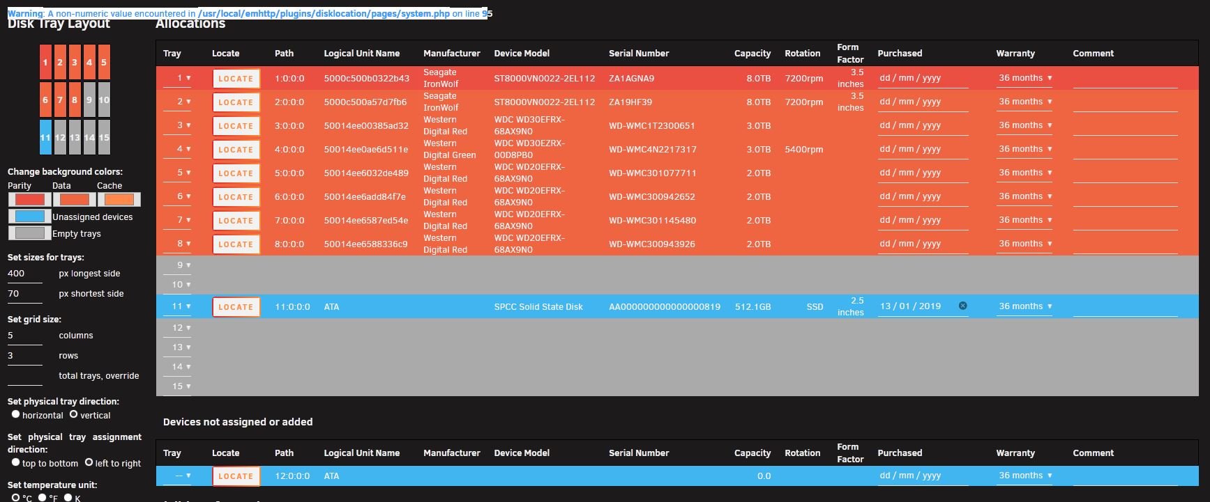

Hi, I have recently set my 2 Cache drives to be mirrored (i thought they were be default but then saw Spaceinvaders video ) anyway that sorted, but this plugin now only sees 1 drive and 1 blank space but can see something is there. (it used to just show 2 separate drives) I have tried uninstalling and reinstalling and searching through here to make sure it hasn't been brought up before. not a major issue, just was nice to see my 2 blue drives at the bottom, im also getting an error in text on the configuration page. "Warning: A non-numeric value encountered in /usr/local/emhttp/plugins/disklocation/pages/system.php on line 9" so you can see Unraid sees both drives and the plugin sees something but cant work it out? (or my Cache is borked as im very new to this ) Is there a way to have a mini version of the location page on the unraid main dashboard, so you can see an overview of your whole system? Thank you very much!
