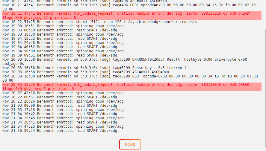

  9. In the disk log information, see attached file. I will run the extended self test. Data looks fine so far. I haven't written anything to the server yet. Dockers and VM's are not running, so I don't know about my media.

  11. So the restore has finished, i'm still backing up some files to Dropbox. How to check if the restore went good? disk1 still shows read errors. Should I create a smart report from that drive?

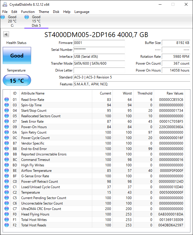

  14. Attached the cristaldiskinfo screenshot
  15. I do not unfortunately. My array is still reachable, so I could create a backup but I don't have a medium to back it up to. Yes I can connect the original disk2 to my pc, which software do you recommend to create a smart report?
