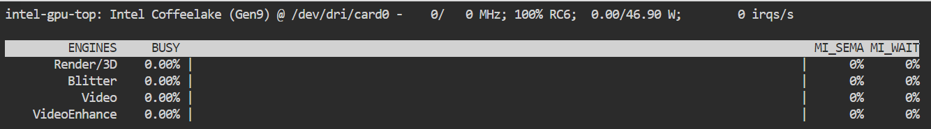

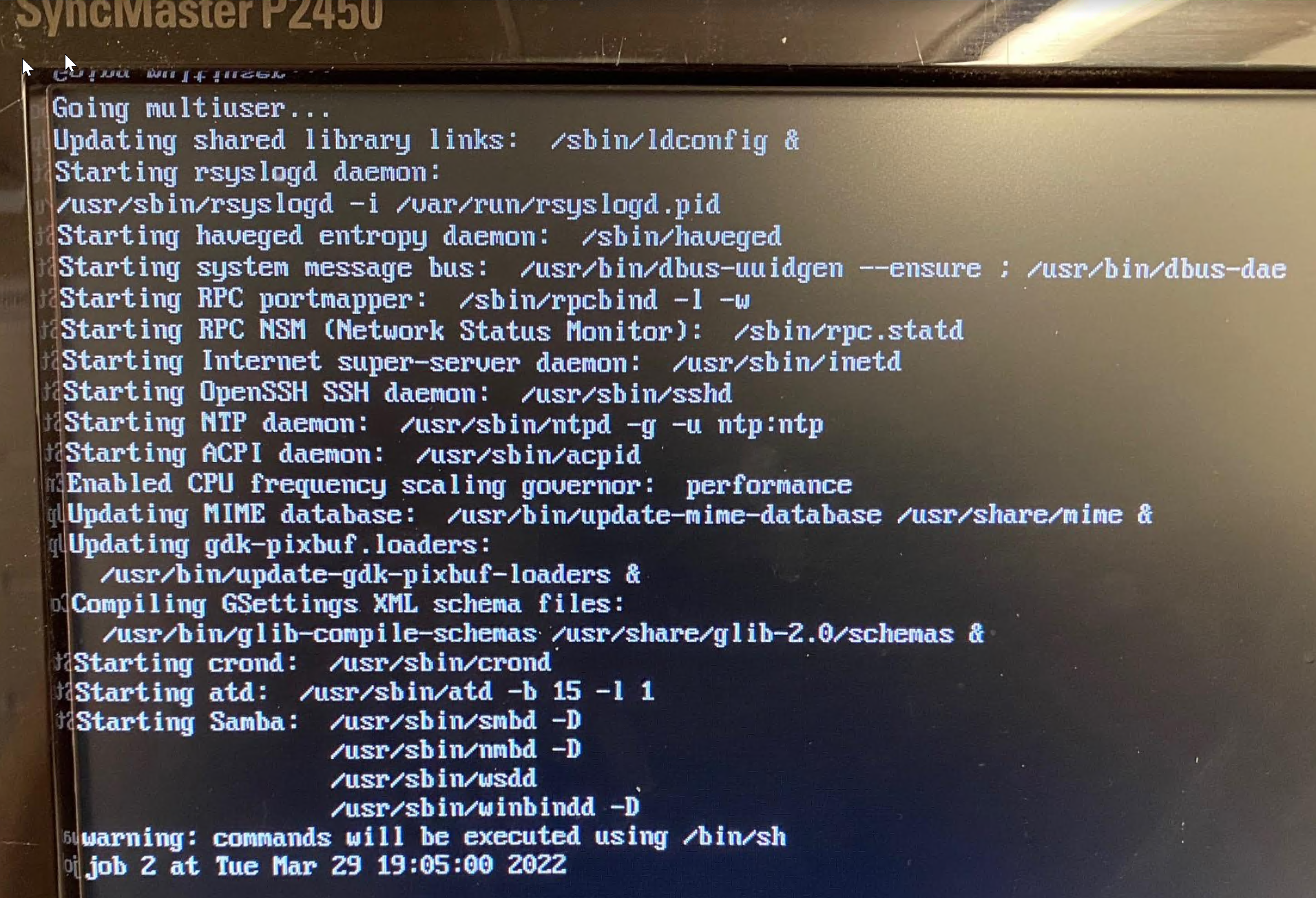

  13. Yes I use the internal GPU for output of the UI I already had the plugin, this is what I see - if I write the command "intel_gpu_top" Diagnostic attached Also tried to do a video capture during the boot screen but the captures above is the last I see Please let me know if I can do anything else to help finding this problem 🙂 diagnostics-20220411-0851.zip

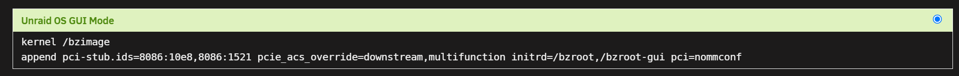

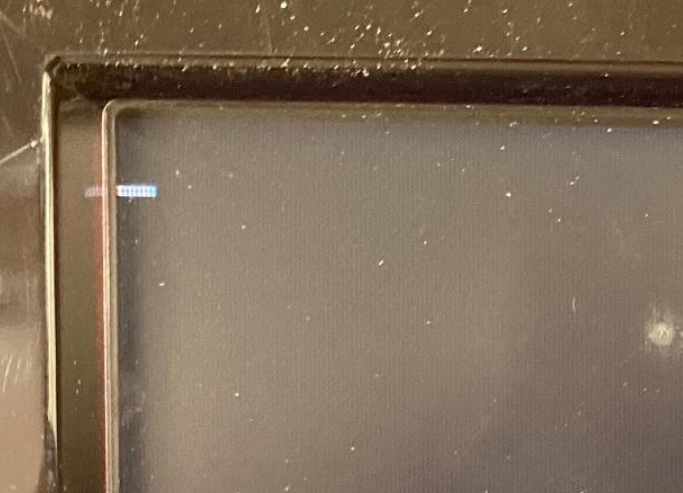

  14. Hi All I cant get the "local UI" up on my monitor anymore? Searching the Unraid forum I found some talk about the "VM backup plugin" causing some problems so I have uninstalled it But I still cant get the GUI/Browser up on my monitor at boot it works fine and I can see all the disk being found but in the end I get this And then after some time just a cursor: Is there anything I can "reset" on the USB? I have my conf. set to always boot to the GUI, and it used to work? Hope someone can help I just got a big new screen to get Unraid up and running on 🙂
