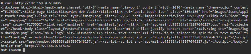

I am beginning to think this is just "one of these dockers" that isnt working with a proxy Yes the : http://192.168.0.6:8282 will provide me with the same error page Only http://192.168.0.6:8282/youtube-dl will work Yes just doing the curl for a port not in use: Doing it for my Bitwarden container and it shows up fine.... So some containers is just not "seen" from the NMP and these will never work?

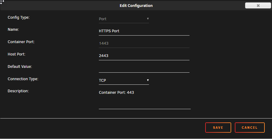

I just removed the docker and deleted the docker image. I then re-installed it with my previous settings and I still have the container ports wrong? They are greyed out in the Docker config, is there anywhere I can set them manually in the docker config folder?

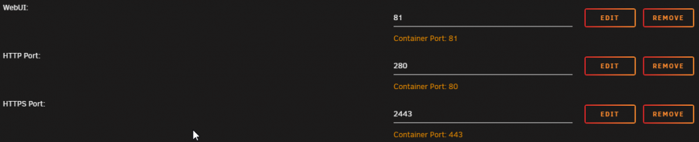

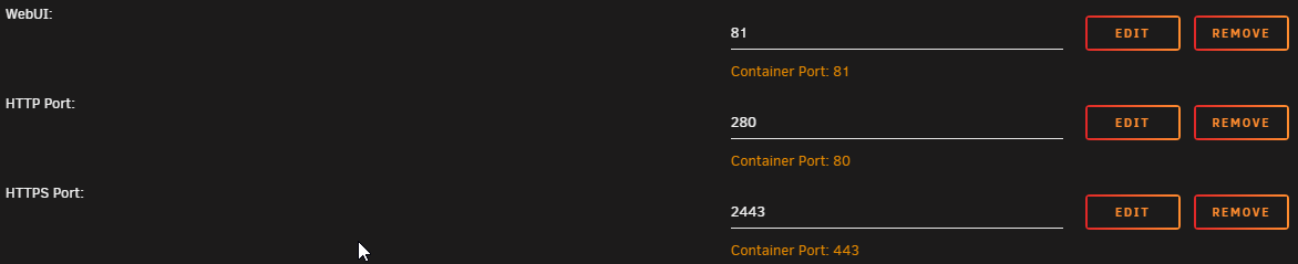

No I only changed the ports like before not the container ports I started the docker: Opening the settings I can see: Opening the EDIT HTTPS: The container ports are changed to the same port as my Host port? And only way to get it back is doing a re-install This is so strange, it happens when I change Host ports or I change network between Host & custom net Prox net? - can it be somekind of bug? (I have refreshed the webpage and the values are not cached)

Hi When I cahnge ports the container act funny But inside it looks okay: So far the only way to fix the port this have been to remove the container and install it again? If I change the proxynet to host : How can it change the ports... I can access the UI but the proxi stopped working after the port change (And yes the ports are open) Also disabled any 443 redirect to unraid disabling the "My server" remote access feature I love the docker and the UI but it dosent seem as stable as Swag?

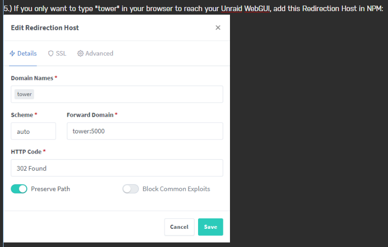

I just installed the NMP Official (Had the old docker) and set everything up like you wrote Except the 5000/5001 (Synology ports) so I changed it to 6000/6001 But now the Unraid comes with the "My Servers" plugin and when this is running and I try to do the: (I use 6000 and my own server name ;-)) I can not access the UNRAID UI anymore...... So is there any workaround for having this setup with the "My Server" plugin Remote access from this requires you to let Unraid get a cert. and run HTTPS Br Casperse

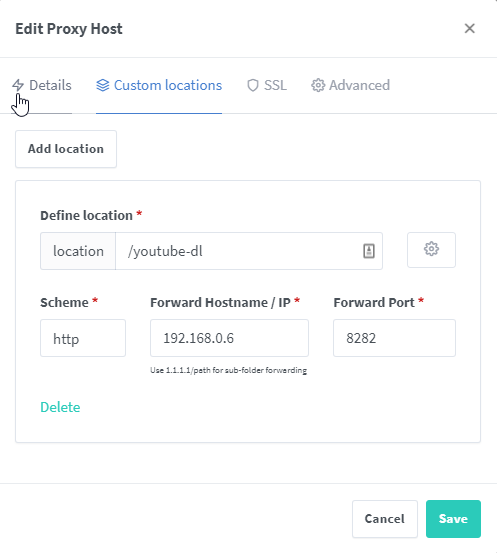

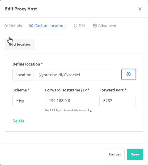

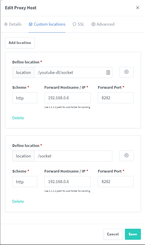

Yes I did try the /youtube-dl... and thanks for the suggestion Unfortunately this doesn't work either

I am now finally moving from SWAG to NPM But some of the more difficult ones I cant get working youtube-dl-server This docker have a url path that goes like this: http://192.168.0.6:8282/youtube-dl SWAG worked by doing this: # make sure that your dns has a cname set for youtube-dl-server and that your youtube-dl-server container is named youtube-dl-server server { listen 443 ssl; listen [::]:443 ssl; server_name youtube.*; include /config/nginx/ssl.conf; client_max_body_size 0; location / { include /config/nginx/proxy.conf; resolver 127.0.0.11 valid=30s; set $upstream_app youtube-dl-server; set $upstream_port 8080; set $upstream_proto http; proxy_pass $upstream_proto://$upstream_app:$upstream_port; proxy_set_header Range $http_range; proxy_set_header If-Range $http_if_range; } location ~ (/youtube-dl/)?/socket { include /config/nginx/proxy.conf; resolver 127.0.0.11 valid=30s; set $upstream_app youtube-dl-server; set $upstream_port 8080; set $upstream_proto http; proxy_pass $upstream_proto://$upstream_app:$upstream_port/youtube-dl; proxy_set_header Upgrade $http_upgrade; proxy_set_header Connection $http_connection; } } Can someone point me in the right direction 🙂

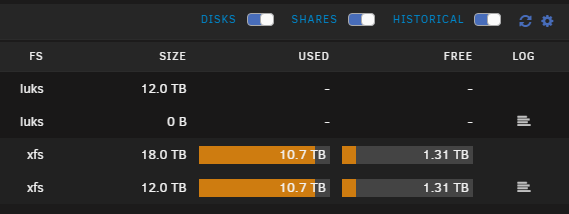

Sorry did a reboot and then everything was okay again, so some caching of the old drive was somehow still shown by UAD
After renaming and unmount and mounting again I get this: rsync dosent copy partitions, so somehow UAD is caching the old mounted drive with the same name and showing 12.0TB on a new 18TB drive Anyway to fix this? stop and start UAD services?

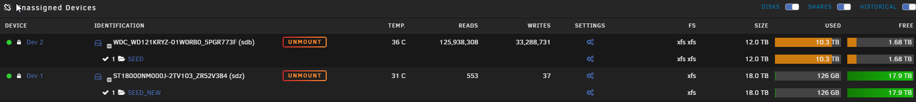

Hi All I am replacing a 12TB Unassigned drive with a new 18TB and I did a: rsync -avPX /mnt/disks/SEED/ /mnt/disks/SEED_NEW/ and later a update: rsync -auPv /mnt/disks/SEED/ /mnt/disks/SEED_NEW/ But after unmounting the drives and renaming it to the "old name" replacing my old UAD drive I keep getting this: After remounting the drive I no longer have luks (encryption) and also it shows the drive as 12TB partition under the 18TB drive Is my rsynch command wrong? is it UAD that somehow just cashes the old drive (I havent re-booted - to many things running so I cant right now)

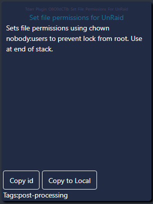

So I found a Unraid plugin in the stack for permissions But when I add it I get error: Pre-processing - Set file permissions for UnRaid Plugin error! Error: Command failed: chown nobody:users I remember in the docker resilio-sync you could do a: Any input on how to get this working? Thanks!

Sure thing! - The mount and drive works perfectly so this is just a UI thing 🙂 diagnostics-20210926-1203.zip
Thanks - And the double xfs,xfs is beacuse it list the partition below?
Removed the partition on the new drive and formattet id with XFS encrupt. did a reboote and now have the old drive with xfs, xfs again?
