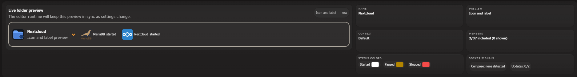

  1. Hi folks. I've been using FolderView2 for some time now, but decided to update to FolderView Plus. Everything is working great, apart from it's not recognising that a container has an update available. As you can see in the screenshot, I have a folder for Nextcloud, and the MariaDB container has an update available, but the folder still shows "up-to-date". The other screenshot is the settings page for the folder, where I noticed the "DOCKER SIGNALS" section shows "Updates: 0/2". Not sure if this is related, but it's as far as my diagnosis has led me. I've tried clearing my browser cache (I'm using Chrome), and I've even cleared all the FolderView Plus configuration that I imported, and started from scratch, but I still get the same issue. Am I missing something in the configuration?
