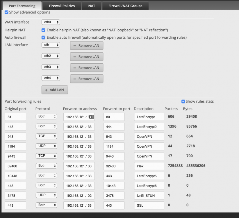

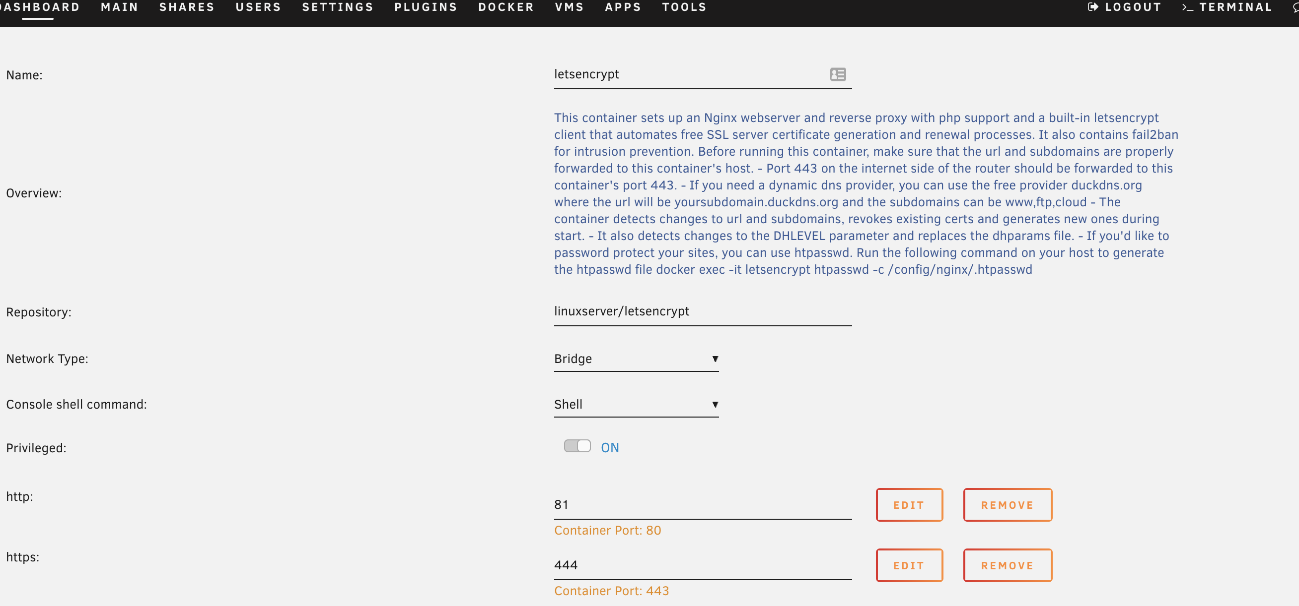

  8. @deepthought I changed those settings and I'm still getting the same issue on my end, I guess the next step would be to revert to default settings and see if that fixes the issue? Also just to confirm I have the right ports, I did attach a screenshot of my letsencrypt docker ports edit: Another thing I just noticed, is that if I type my normal duckdns URL without the /sonarr behind it, it does bring me to my router settings from inside my network and doesn't give me any errors. Edit2: I did reset everything to default and kept the same settings as I posted with no fixes.

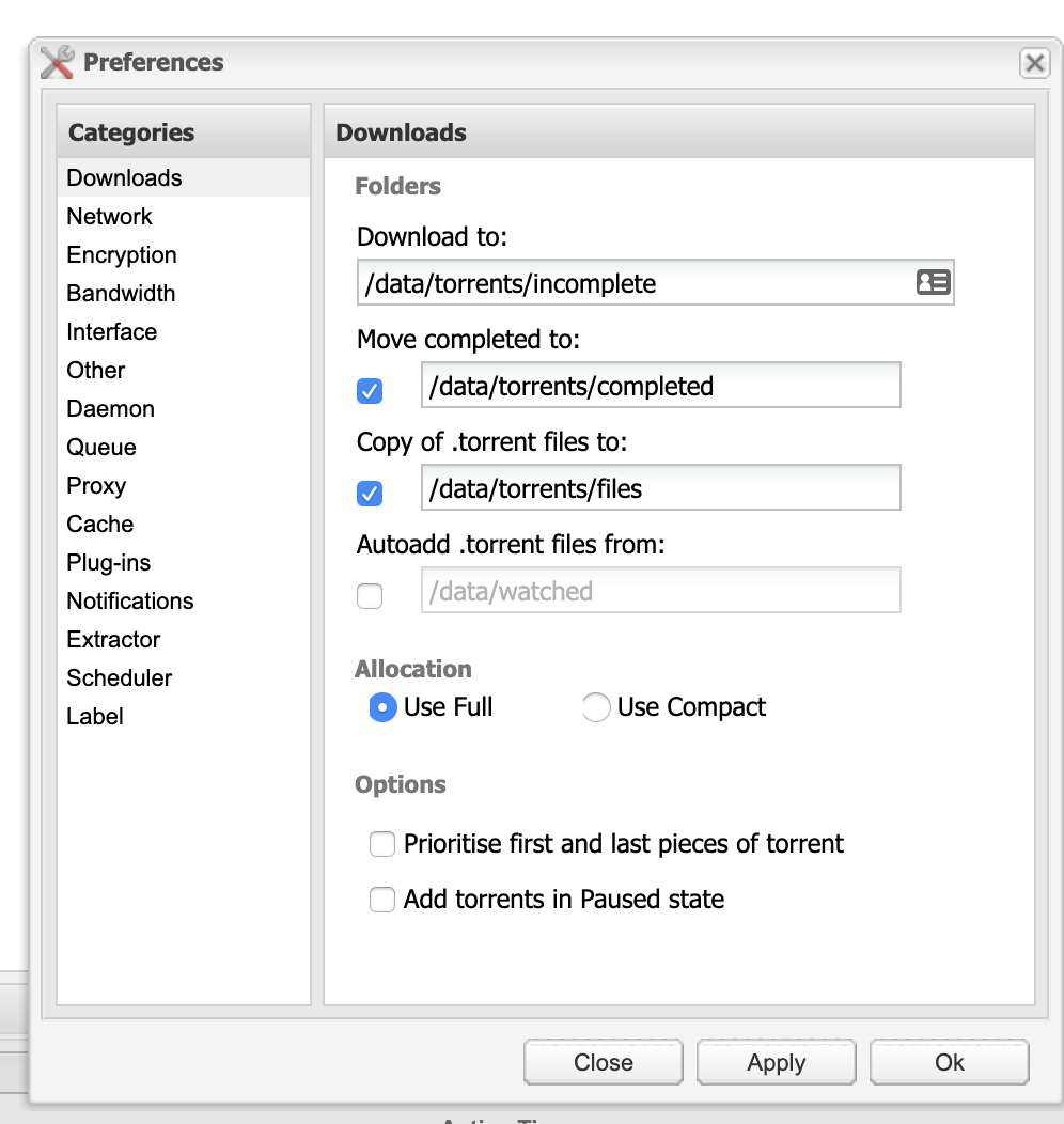

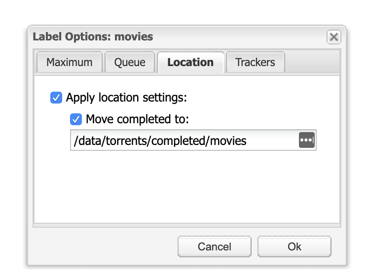

  11. So I had auto-updates turned on and saw that it updated Deluge to 2.0. Unfortunately, some of my private trackers do not have that whitelisted, so I went ahead and downgraded with the following build. binhex/arch-delugevpn:1.3.15_18_ge050905b2-1-04 When I did that, it booted up just fine, except it lost all of my torrents (All my settings seem to be good). I had over 200 torrents. is there a simple way to re-add all of my torrents? I have them all moving to a completed folder when they finish, so I didn't think I could just re-add the torrent files because I thought it would just re-download them all unless I pointed over to the completed folder, which is not something I'd really want to do at this point. I tried to restore from a previous CA Backup / Restore Appdata from a few days ago, but after I copied over the files it still booted up with zero torrents in the program. I've attached a picture of my completed torrent folders to show where they download and move to. (I also have labels set up to auto move completed to folders based on those labels. Any help would be appreciated, thanks!

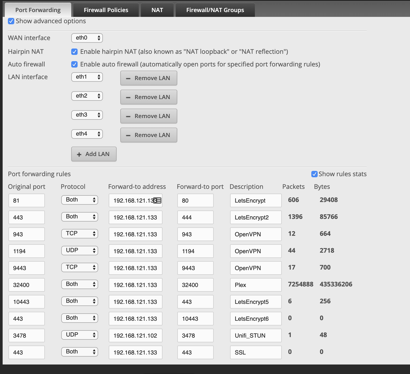

  12. Thanks, I really do appreciate the help, I took out the one 443 port, I think I just started adding ports when it stopped working. I swapped the 80/81 ports around and got rid of some of the ones that I added after the fact. I rebooted the router and tried from an incognito window to see if that helped, and I still have the same issues. Here are my ports now.

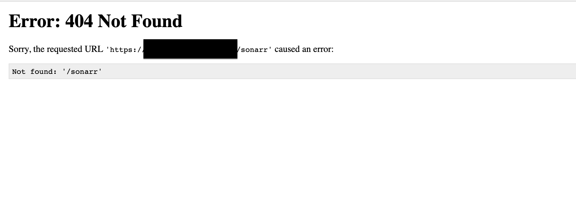

  13. I have the same exact issue and I can't figure it out for the life of me, I think it has something to do with the ports I have forwarded in the router, but I had it working on my previous router, and this only started when I upgraded my wireless/network over to Ubiquiti & Unifi. I've attached the ports I have open, again copied exactly from my older router setup. Everything works perfectly from outside the network, but when I try to connect to my duckdns address from inside I get the following error Error: 404 Not Found Sorry, the requested URL 'https://xxxxxxx.duckdns.org/sonarr' caused an error: Not found: '/sonarr'
