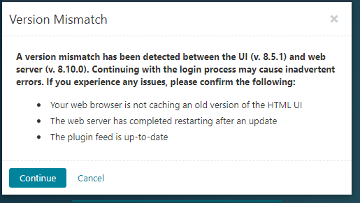

  1. Thanks OP for creating this. I just installed it to test it.. and encountered a couple of error messages. Hopefully they are helpful for your troubleshooting. Upon initial login/setup of user account, I receive the following error when trying to start a scan. Then upon logging in again I get this error
