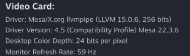

  1. After some trial and error, I got it working :-). Originally I passed through the GPU after installing the container. I removed and re-added the container and made sure the GPU was passed through before running it for the first time. Looks like that did the trick.

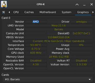

  2. Definitely a driver issue works fine on the Intel iGPU. Hopefully the docker is updated to include the latest drivers.

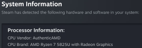

  4. Hi, Trying to get this up and running but it des not seem to recognise my GPU and games will not launch. Any way to force a driver?
