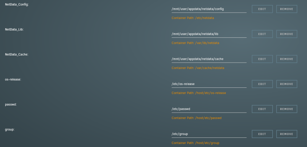

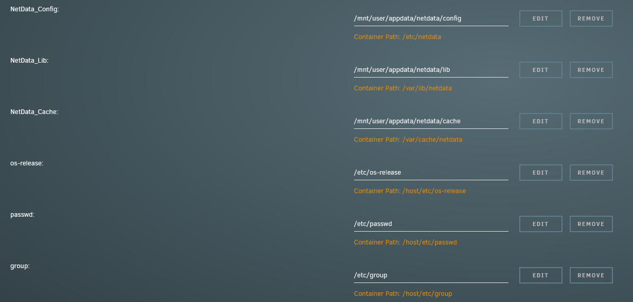

  6. If you have the latest version of the template (updated at the end of October) you'll have all you need in the template for Cloud. To see where the container is creating the AppData, click "Show more settings" at the bottom of the netdata docker settings page. In there you'll see three paths: NetData_Config, NetData_Lib, and NetData_Cache. Make sure all 3 of those are mapped or you'll have issues with NetData Cloud persisting data and setting up the config for Alerts. Go to https://www.netdata.cloud/ and sign up for an account. You'll get to the point you'll be given instructions to install netdata on something and those instructions should have a Claim Token, Claim URL, and a Claim Room. You'll paste all 3 of those into the 3 fields into the template and Unraid should start showing up in Netdata Cloud. To setup the Discord portion, this should walk you through it: https://learn.netdata.cloud/docs/alerting/notifications/agent-dispatched-notifications/discord When you get to: sudo ./edit-config health_alarm_notify.conf Ignore the sudo command. If you do the Test Notification section, I don't think you'll do the following: # become user netdata sudo su -s /bin/bash netdata To change the ram alert settings, run this command after you are done editing the config above: ./edit-config health.d/ram.conf In there you can change the settings to however you would like. For more info on that one, here's the documentation on setting those up: https://learn.netdata.cloud/docs/alerting/health-configuration-reference

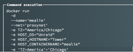

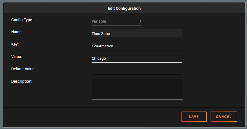

  9. Also, the Time Zone variable is being defined wrong. You could probably remove this entirely as Unraid has started passing a TZ variable through natively at some point.
  10. A change request was merged in two days ago adding all of the missing mounts as well as the needed cloud claim tokens.
  11. The template has that taken care of with an argument in Extra Parameters. This template is ready to go if you want NetData locally. If you want NetData Cloud to work properly, you'll need to add the variables and path mappings from these two posts I made.
  12. If you mean having to add it back to the cloud every time, check my post above yours. That shows the additional mappings to add to keep that from happening. I'm working on submitting a pull request to roland to update this template with those values.

  14. One other thing I noticed after a couple of reboots is that if you don't persist some of the directories in this docker, it will show up as a new device in NetData Cloud. I added these mappings to fix that and get the OS to show correctly (Slackware) and to fix group/user enumeration.
