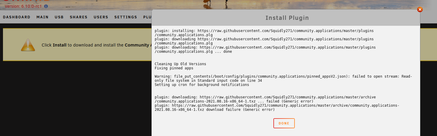

This happened right after I updated to 6.10 Rc1 and I cant install this manually through the plugins nor can I install it through the new install button in unraid 6.10. BTW it was installed before and it asked to update, and instead it just wiped out the plugin and it is now missing entirely. No idea how it's read only... Weird. Diagnostics also attached. connollyserver-diagnostics-20210820-1620.zip
