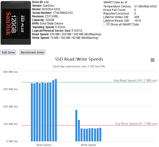

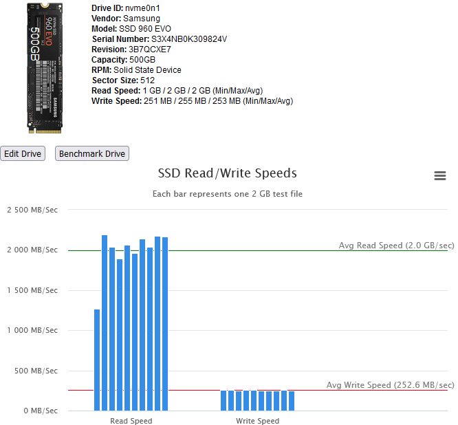

Right Proper SSD benchmarking has been added. To perform a benchmark, a configurable number of test files of a given size (defaults to 10 2GB files) are written to the drive and then read back. The overall time taken for each is used to compute the MB/Sec average for the file. Restriction: SSD's that exist in a multi-drive pool are excluded. To benchmark a SSD intended to be in a pool, use the "Unassigned Devices" plugin to format & mount the SSD and restart the DiskSpeed docker. After benchmarking, use "Unassigned Devices" to clear the partitions and then add to your pool. While the system cache is bypassed when benchmarking, some devices have a built-in cache that ignores cache bypass commands. An initial high write speed that quickly levels out is a sign of such as shown below.

That'll be inadvertently resolved in version 2.10. I'm adding proper benchmarking of solid state devices by writing multiple files to the device and then reading them back taking the averages. Highcharts is giving me issues with the multiple x & y axis on one graph, the width of the bars get smaller the larger the spinners included are. Bench marking solid state devices will be limited to ones in an array slot or a single drive pool and requires a mounted partition with 25GB free space available (based on default benchmarking configuration). You'll be able to test write/reading x number of files of y size. I'm also leaning towards allowing write benchmarking of spinners but that'll definitely require a drive with no partitions and will likely not be included into version 3.0.

It was supposed to loop from 0 to 9 instead of 1 to 9. I made that change. I'll take a look at the block size computation. Can you email me a small debug file from the "Create Debug File" from the DiskSpeed app to [email protected]? I'm currently adding proper SSD benchmarking so it's kinda moot in 99% of the cases. It will write ten 2GB files and then read the ten files back taking the min/max/avg times, bypassing the system cache. Requires a mounted partition with at least 25GB of free space. That logic is done, now working on figuring out how to render that on a chart with a stock ticker reflecting the three values. Thank you, I'll investigate.
