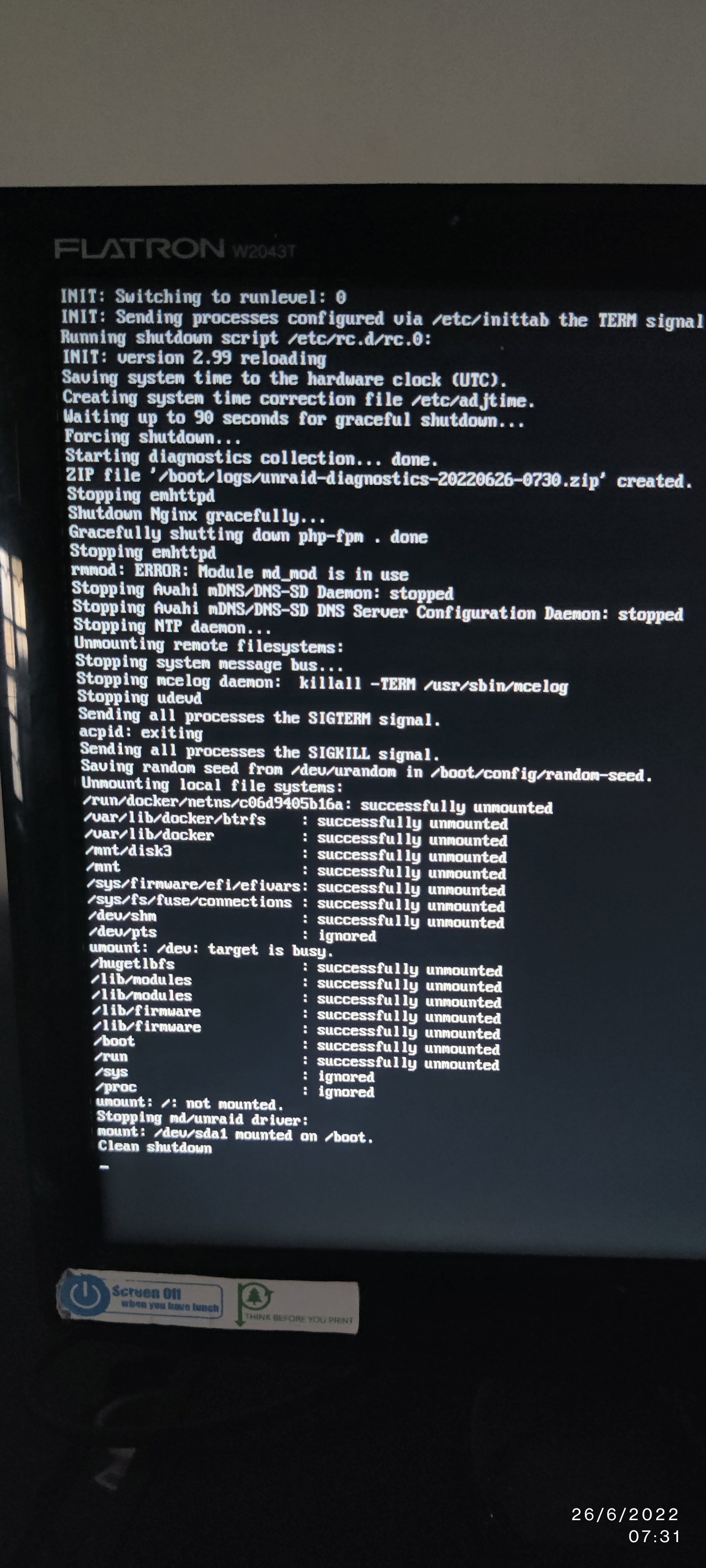

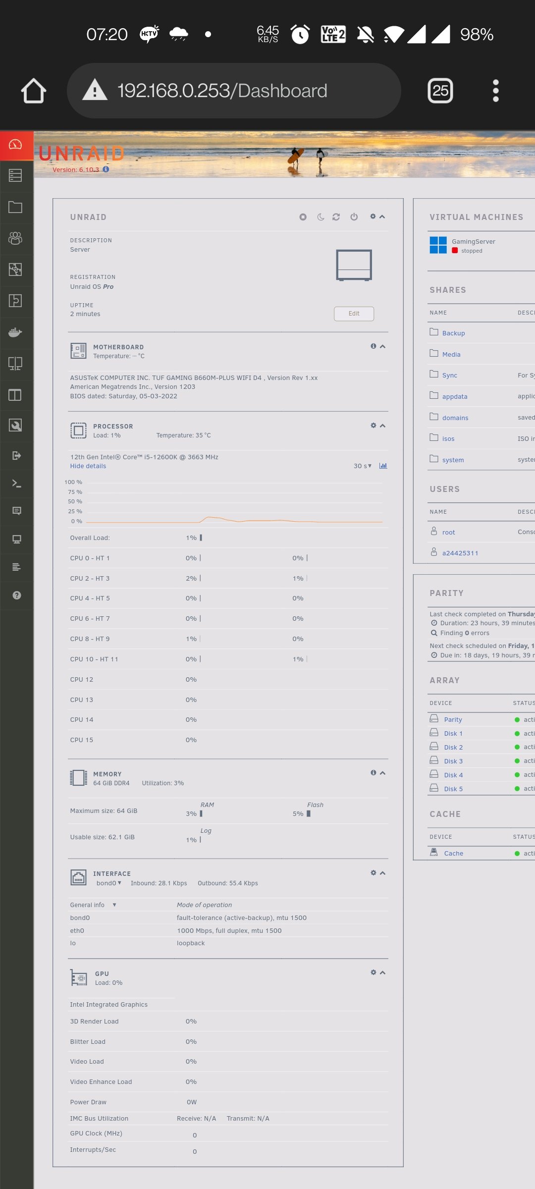

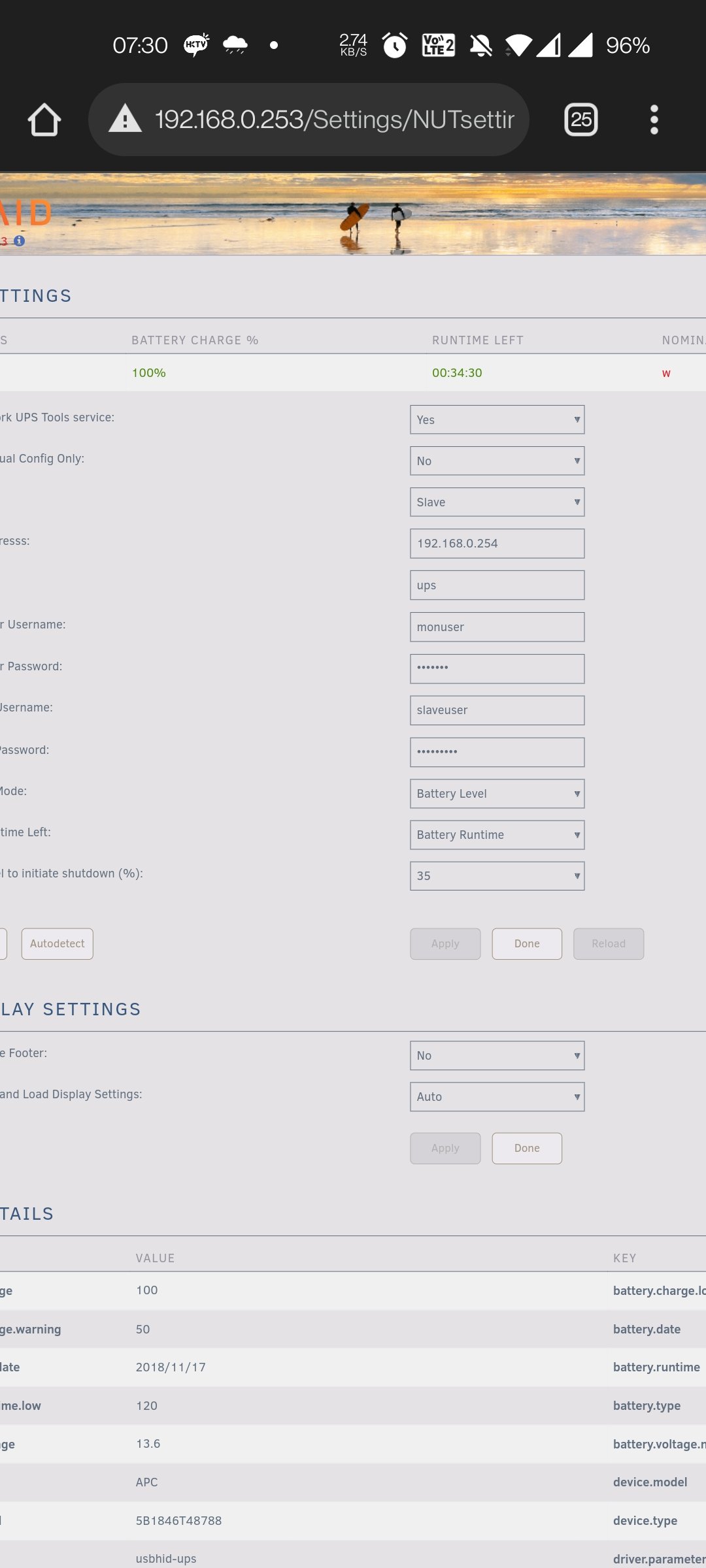

  6. I have been using NUT plugin since it launched (slave, master was my Syno server), it was running very fine until recently I upgraded my unraid rig, it gives me an immediate auto 90 sec shutdown after powering up, shutdown load was set at 20% and my load was still 100%/30+ mins, any thoughts? Thanks for reading. 05/July Little update, i solved the problem by resetting the UPS breaker (arent so sure if it was caused by the breaker but just work.)
  7. Thanks now i believe it was caused by gpustat.plg, let me remove it and do a fresh install see if it fixes the problem.
  8. Thanks, Syslog attached. yesterday i installed INTEL GPU TOP and GPU stats for jellyfin server, don't know if it changed some of the setting. syslog

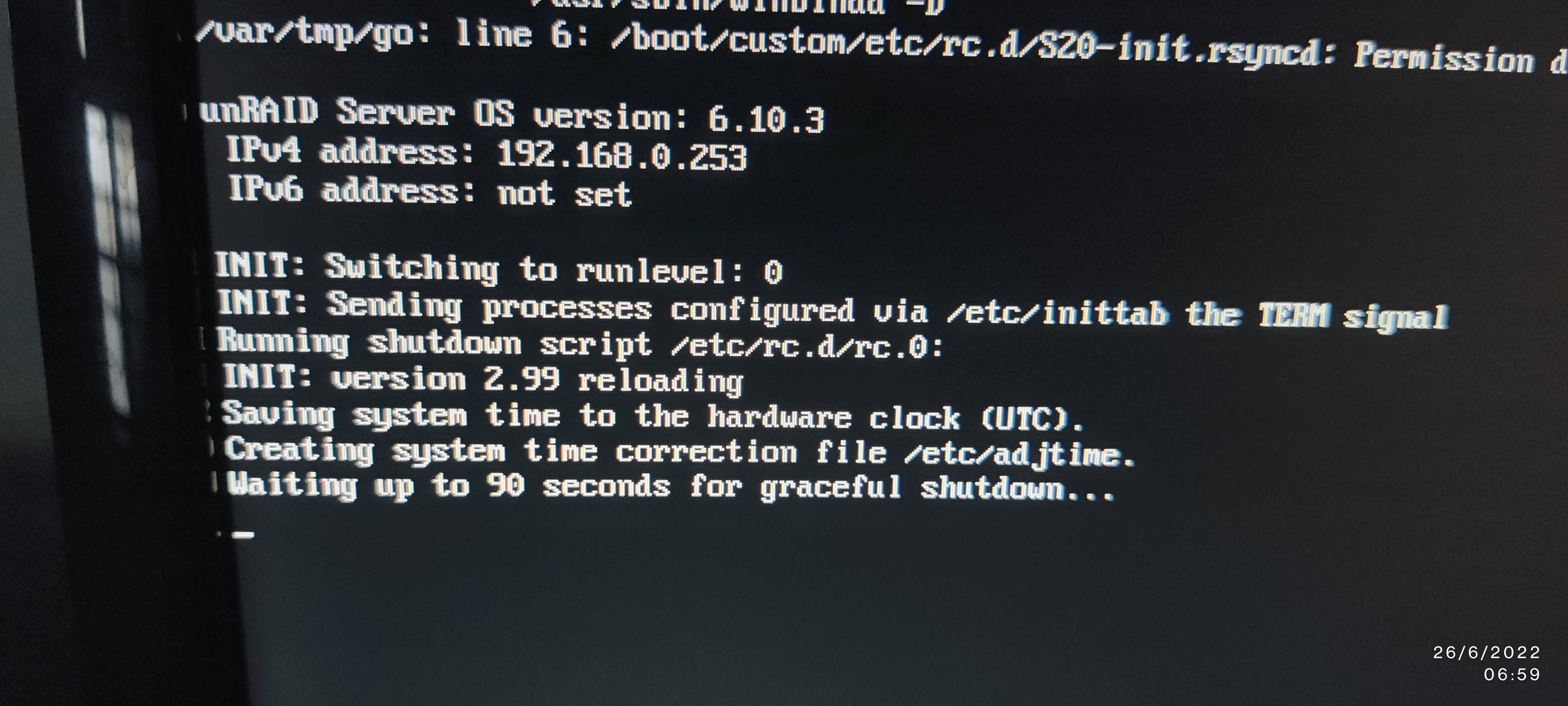

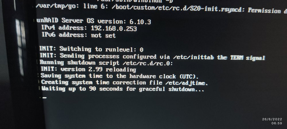

  9. Able to boot up without shutdown in Safe Mode, attached with diagnostics file unraid-diagnostics-20220626-1157.zip
