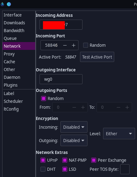

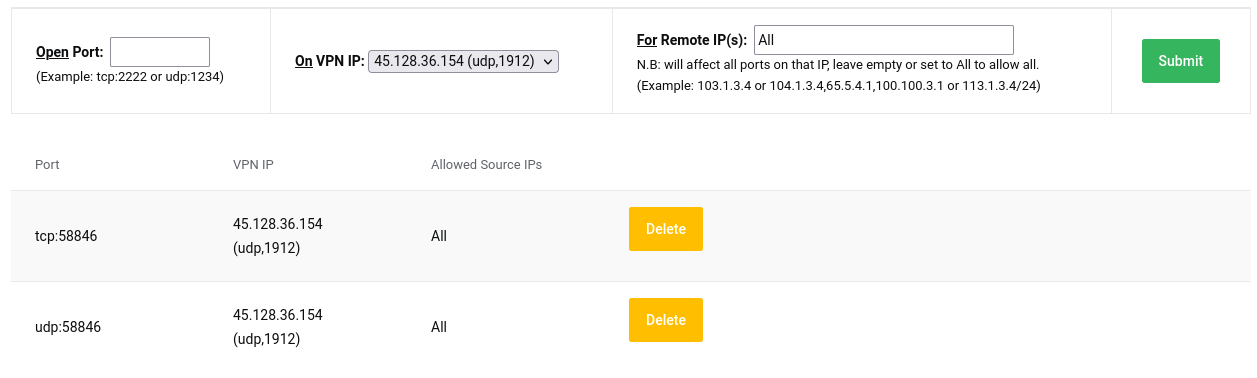

  4. I removed the port forwarding from the router. I also requested a new port from torguard (one that is not in use by any other container) and updated the wireguard conf file "ListeningPort" parameter to this new value. I needed to make one other correction, however. Instead of using this port in the deluge network settings "Listening Port", I used the port from the torguard "manage ports" page in the column named " VPN IP" instead of the new port listed in the "Port" column of that page. I am now connectable. Thanks for the guidance, @strike.

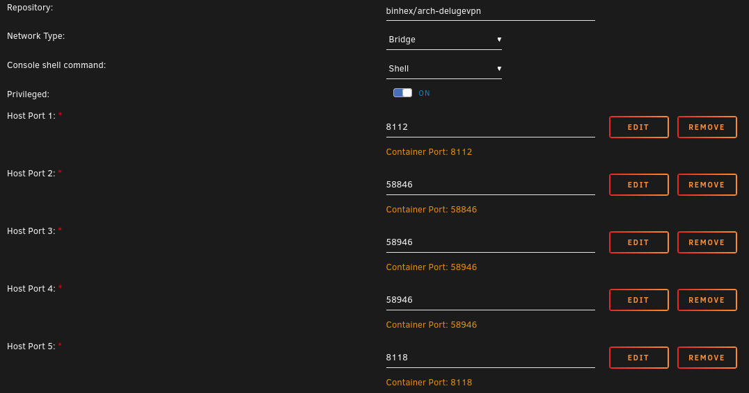

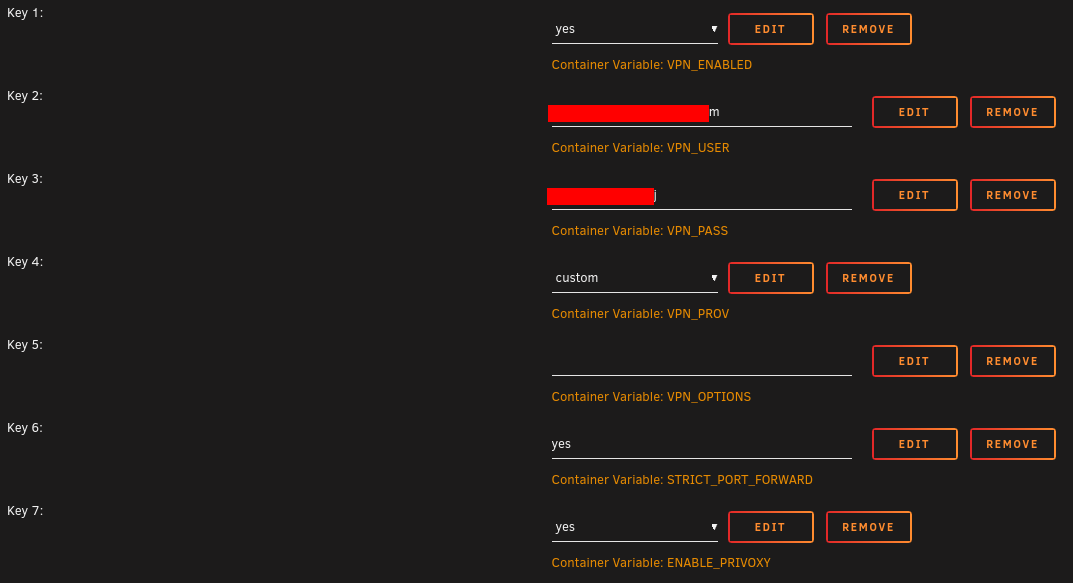

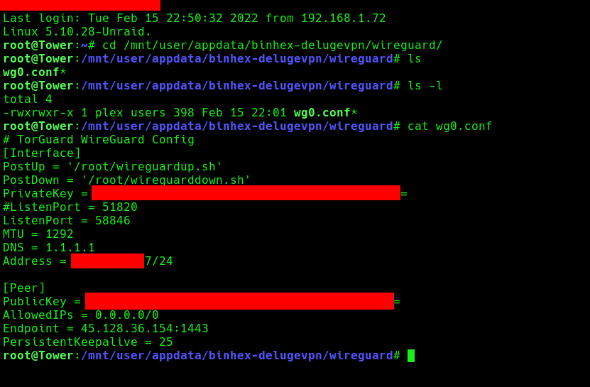

  5. I'm hoping for some assistance setting up with custom VPN (torguard). I'll outline the steps I have taken. I followed the guide here (archived link) to request a port from torguard I requested port 58846 on the Chicago server (45.128.36.154). See image in spoiler below I added the conf file generated in the guide to `/config/wireguard` directory. I updated the listening port to 58846. See image in spoiler below I made sure that the container was running in privileged mode per FAQ A21. See image in spoiler below I changed `VPN_PROV` to "custom" and entered new torguard credentials. See image in spoiler below I added a new key/value for `VPN_CLIENT` per FAQ A21. See image in spoiler below I forwarded port 58846 on my router configuration page. IP 192.168.1.2 is the IP of the server running unRAID. See image in spoiler below I set the incoming port to 58846 in deluge. See image in spoiler below running `netstat -p` inside the container shows "58846" showing up once in the local address and once in the foreign address: It can be seen the in the deluge settings screenshot that, even though I input "58846" as the "incoming port", it shows the active port as "58847". I am also see that I am considered "unconnectable" on my favorite sites. These sites show me as connecting from "45.128.36.154:58847" Any assistance is greatly appreciated.
