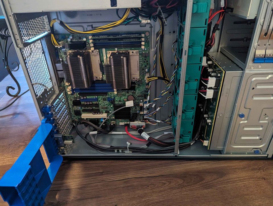

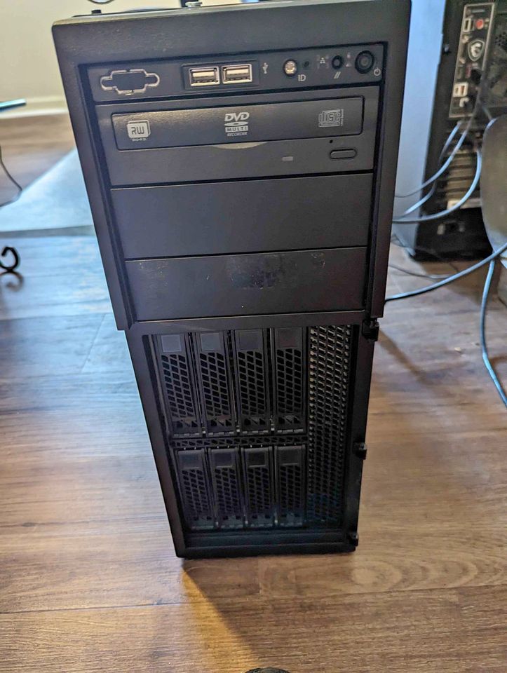

  5. Hey everyone, just scored this for $50! I'm excited because I'm planning to use it to build my second Unraid box. It's got a S2400SC2 server board with 2 Xeon E5-2400 processors, along with 16GB of RAM, but I have enough spare memory to max it out. I also want to add my 1060 GPU to it. Just wondering if this setup is doable or if I might encounter any foreseeable issues. Thanks in advance for the support!

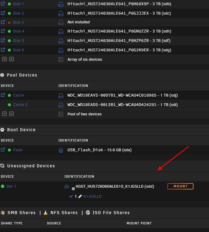

  7. thank you so I changed cables and re booted and now the new drive is showing up in unassigned devices didnt want to press the mount button without checking first and alsodisk 3 is showing up as not installed thanks again server-diagnostics-20230707-1546.zip
