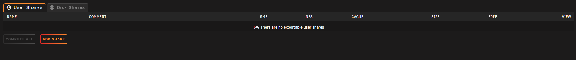

  4. Got a problem with my server, everything seems fine, and suddenly its gone. - Got a Uptime Monitor and its just down, not accessable via Gui or Shell or anything. only a Hard Reset helps.. also Mover is doing moving without pushing files. Any help would be awesome maxisnas-diagnostics-20240804-1659.zip

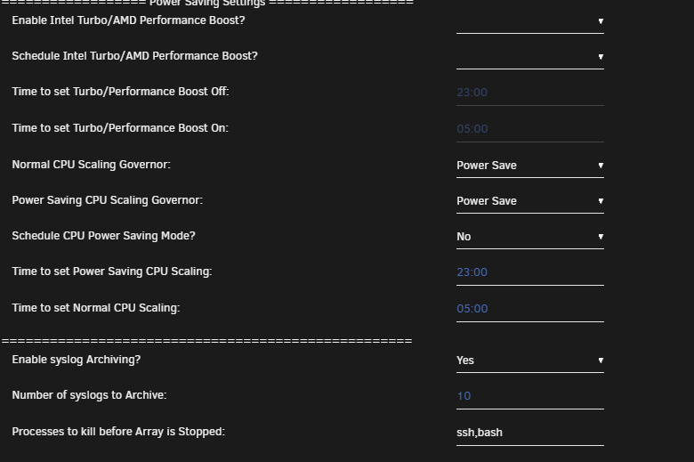

  10. Cpu gouvenor ist auf powersafe ...
  11. Alles im C1... wie stelle ich denn bei Ryzen das richtig ein? Alle Festplatten powerdown sind dann 181w

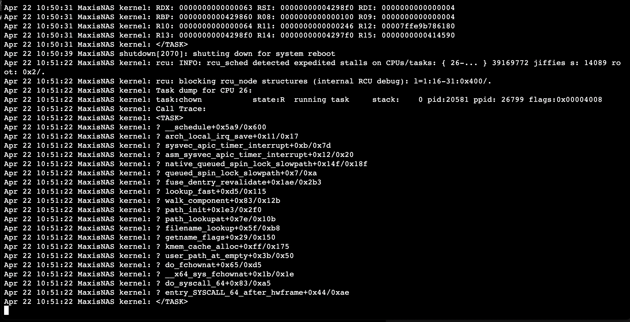

  20. this is the error which i got. cant get diagnostics out of it, fixed the cache partition with xfs check

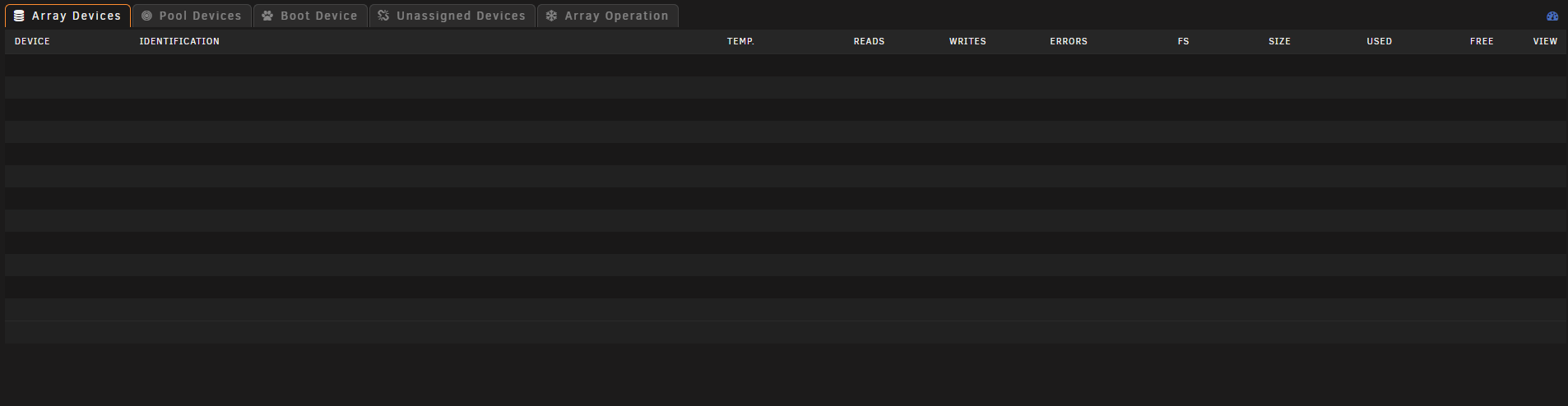

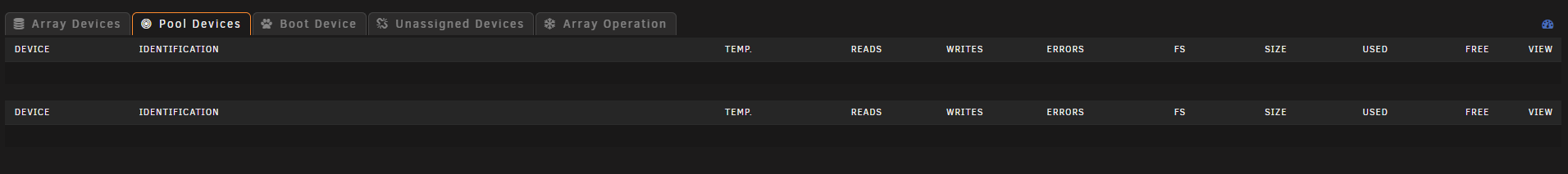

  22. Hello people, Still got some problems with my rig. After a few hours, all disks are gone, even boot drive and cache. Docker containers are still running, like reverse proxy still works.
  23. tried this. still crashes in the middle of the night. I really dont know why this happens. nas is up. hdds are clicking as usual, lan port is also normally blinking, so i really down know why it set itself in this state. maxisnas-diagnostics-20220419-1107.zip
