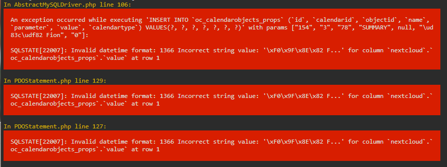

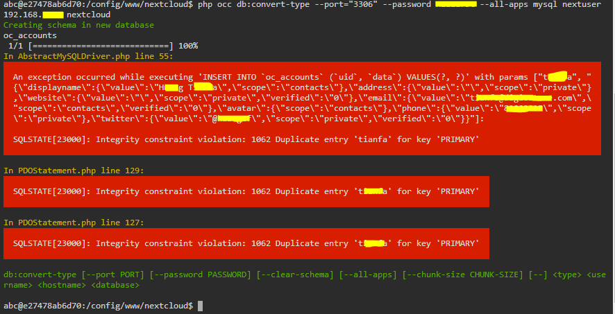

  1. ***Update I found out i got the above error due to running the update twice. Below is the initial error I'm able to clear all records in the new db using the --clear-schema flag I manage to fix the errors using the below commands php occ config:system:set mysql.utf8mb4 --type boolean --value="true" php occ maintenance:repair then running the conversion again
  2. Hi Findus, Following your guide it seems to work fine, but as my installation is an current installation which i've been using, i'm hit with some errors, i'm wondering if any of u have any idea how i can fix it?

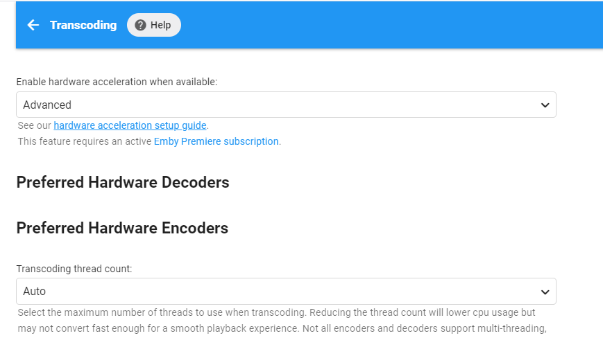

  4. yes, i tried, and its working for emby/emby container, now i'll have to find ways to migrate it, my registration key does not work on the newly installed docker

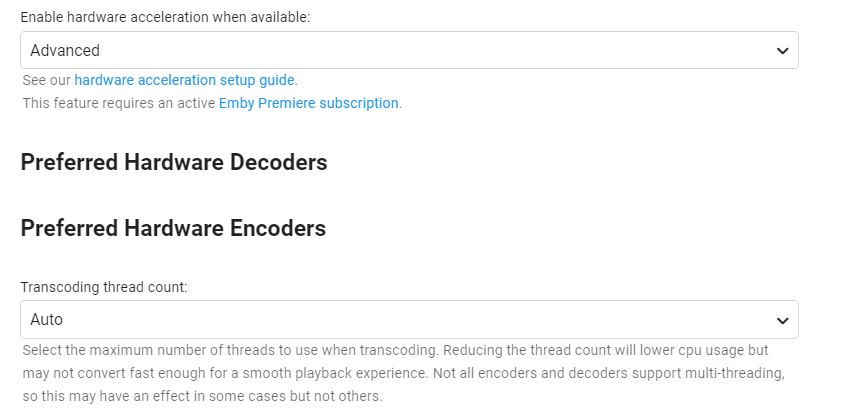

  5. Advance is still the same setting to yes does not work
  6. after booting to headless mode
  7. yes, its booted to gui
  8. Yes, i'm on unraid, I'm unsure y xorg is using it....... i'll try to give that container a try if i can.....

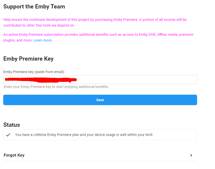

  9. I'm using binhex docker, I have rebooted the container and the server itself quite a few times I'm fairly sure my license is enabled...

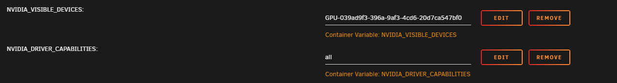

  10. Hi Guys, I cant get the hardware encoding to work on emby. The gpu was detected and and i have emby premiere. am i doing anything wrong? I've gone thru the guide a few times to ensure i didnt miss out any steps
