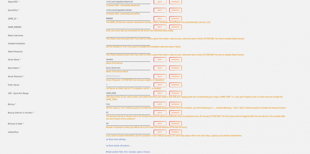

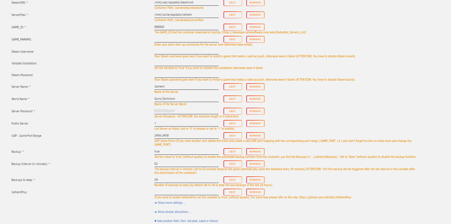

  9. Hi and thank you so much for the container! I'm having an issue connecting to my Valheim server. I have forwarded UDP ports 2456-2458 to my unraid server Here's the log 10-15mins after starting the container: ---Checking if UID: 99 matches user--- ---Checking if GID: 100 matches user--- ---Setting umask to 000--- ---Checking for optional scripts--- ---No optional script found, continuing--- ---Starting...--- ---Update SteamCMD--- Redirecting stderr to '/serverdata/serverfiles/Steam/logs/stderr.txt' [ 0%] Checking for available updates... [----] Verifying installation... Steam Console Client (c) Valve Corporation -- type 'quit' to exit -- Loading Steam API...OK. Connecting anonymously to Steam Public...Logged in OK Waiting for user info...OK ---Update Server--- Redirecting stderr to '/serverdata/serverfiles/Steam/logs/stderr.txt' [ 0%] Checking for available updates... [----] Verifying installation... Steam Console Client (c) Valve Corporation -- type 'quit' to exit -- Loading Steam API...OK. Connecting anonymously to Steam Public...Logged in OK Waiting for user info...OK Success! App '896660' already up to date. ---Prepare Server--- ---Server ready--- ---Starting Backup daemon--- ---Start Server--- [S_API] SteamAPI_Init(): Loaded local 'steamclient.so' OK. CAppInfoCacheReadFromDiskThread took 2 milliseconds to initialize CApplicationManagerPopulateThread took 0 milliseconds to initialize (will have waited on CAppInfoCacheReadFromDiskThread) RecordSteamInterfaceCreation (PID 68): SteamGameServer013 / RecordSteamInterfaceCreation (PID 68): SteamUtils009 / Setting breakpad minidump AppID = 892970 RecordSteamInterfaceCreation (PID 68): SteamGameServer013 / GameServer RecordSteamInterfaceCreation (PID 68): SteamUtils009 / Utils RecordSteamInterfaceCreation (PID 68): SteamNetworking006 / Networking RecordSteamInterfaceCreation (PID 68): SteamGameServerStats001 / GameServerStats RecordSteamInterfaceCreation (PID 68): STEAMHTTP_INTERFACE_VERSION003 / HTTP RecordSteamInterfaceCreation (PID 68): STEAMINVENTORY_INTERFACE_V003 / Inventory RecordSteamInterfaceCreation (PID 68): STEAMUGC_INTERFACE_VERSION014 / UGC RecordSteamInterfaceCreation (PID 68): STEAMAPPS_INTERFACE_VERSION008 / Apps [S_API FAIL] Tried to access Steam interface SteamNetworkingUtils003 before SteamAPI_Init succeeded. RecordSteamInterfaceCreation (PID 68): SteamNetworkingUtils003 / RecordSteamInterfaceCreation (PID 68): SteamNetworkingSockets008 / Here's a picture of my docker setup: Any suggestions? I tried connecting to the server through the steam server viewer with <PUBLICIP>:2457 and <PUBLICIP>:2458
