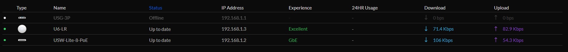

  13. Hey All, I am kind of new to Unraid and saw that this Docker was available. I am so excited that this worked flawlessly from my backup. Thank you for building this for us! I am having one problem. Under my devices, my switch and AP can be seen and updated. But my USG always shows offline. Everything is working, internet is up. Is there something I am missing?
