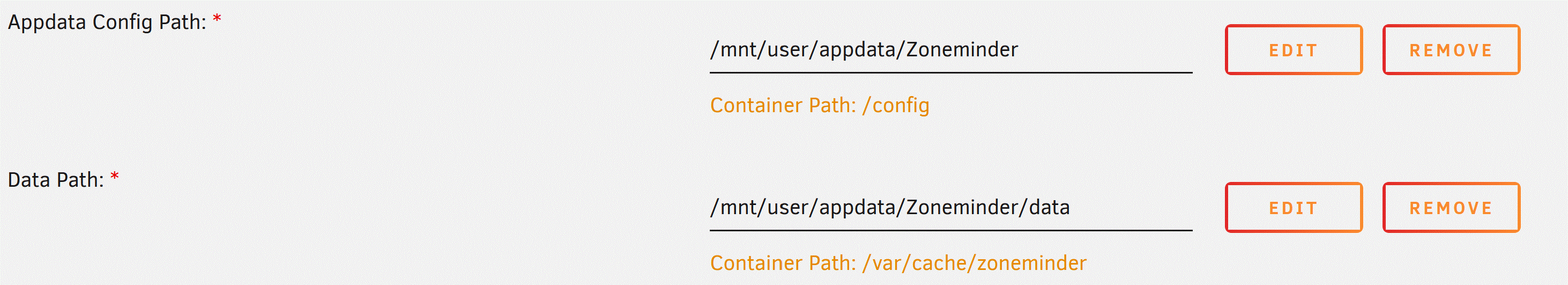

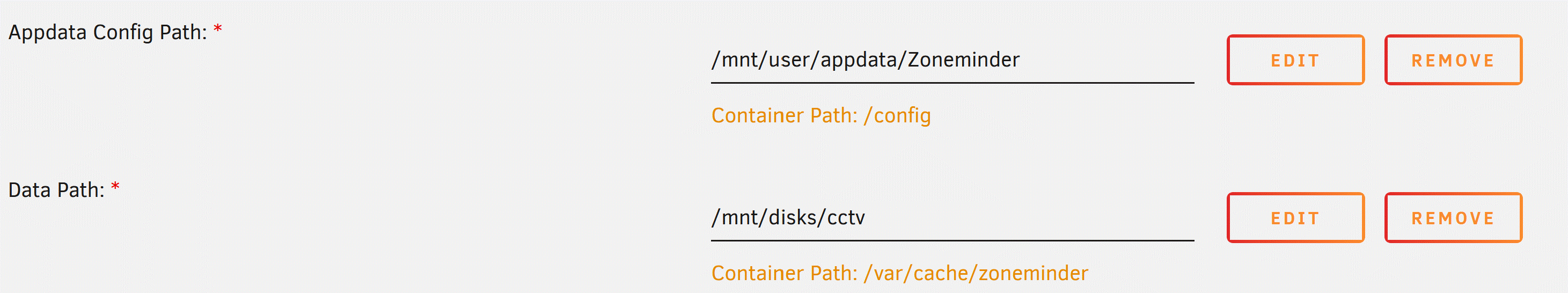

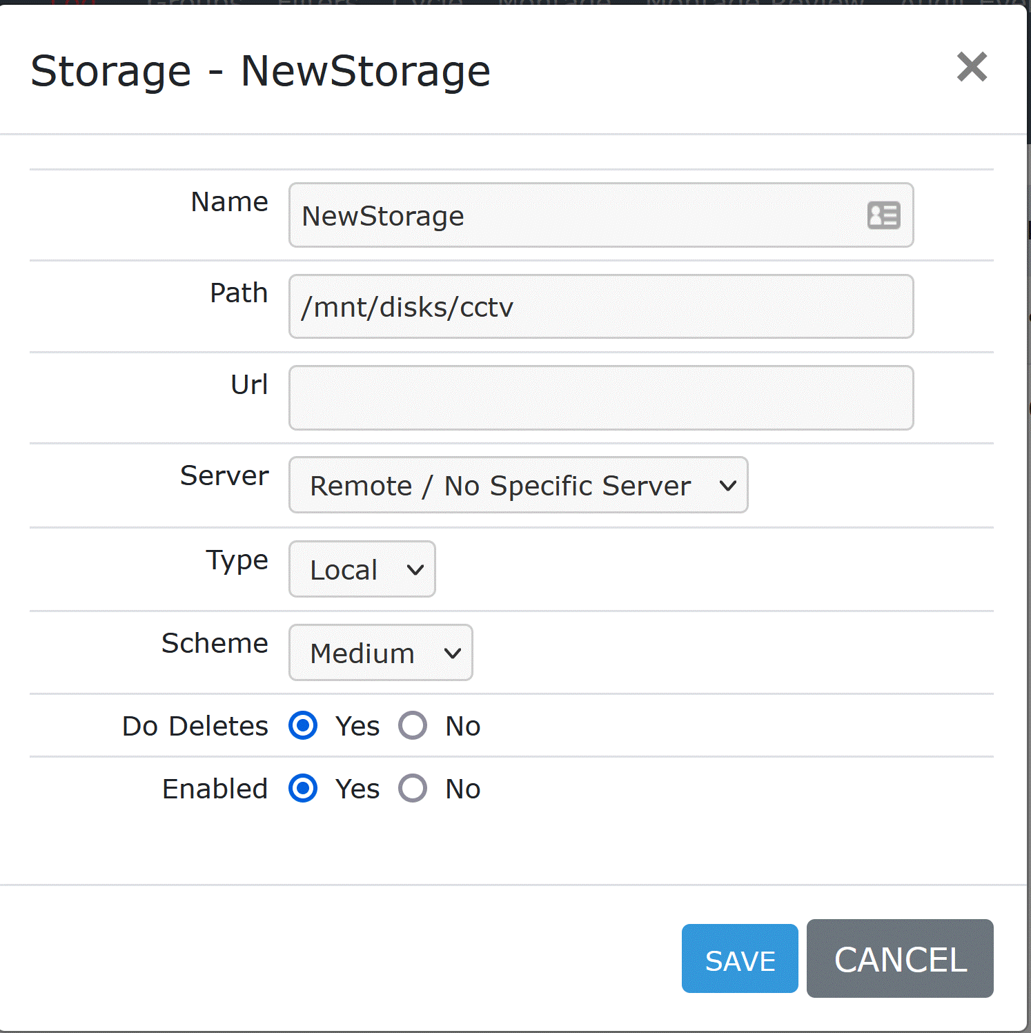

I seem to have sorted this - I was changing both the container and the Web GUI Storage settings to /mnt/disks/cctv - it seems I should have only been changing the container variable, and leaving the Storage setting as is. Consider this solved (for now 😉)

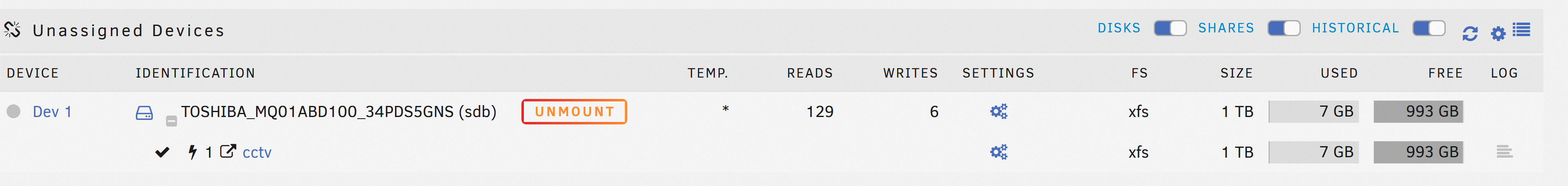

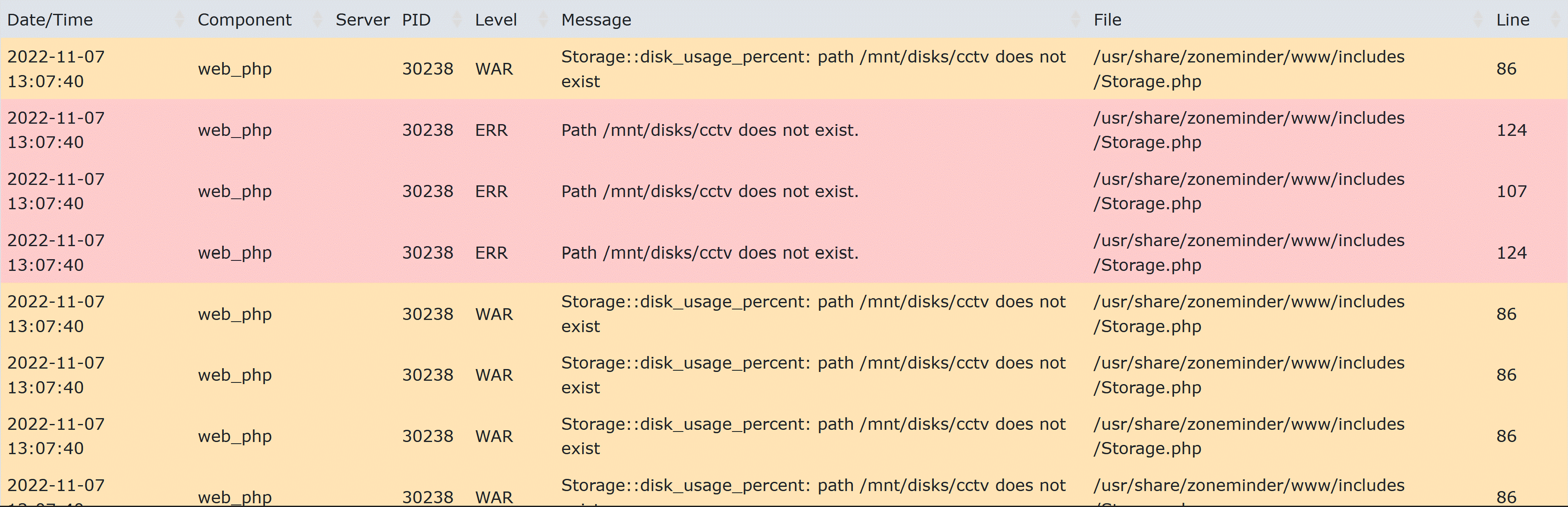

Hi - I am setting up ZM on unRaid 6.11.1. Everything works fine (no cameras yet, but that shouldn't matter) if I accept the default storage paths at installation - no errors in the log. But when I assign a USB 3.0 drive in Unassigned Devices and configure the ZM container settings and the Zoneminder/Options/Storage settings to use the USB drive for camera footage,etc - I get 'Path does not exist" errors in the ZM log. Here are screenshots of the default working settings in the ZM container settings, followed by Unassigned Devices settings, and ZM container and web GUI settings. Any assistance would be appreciated.

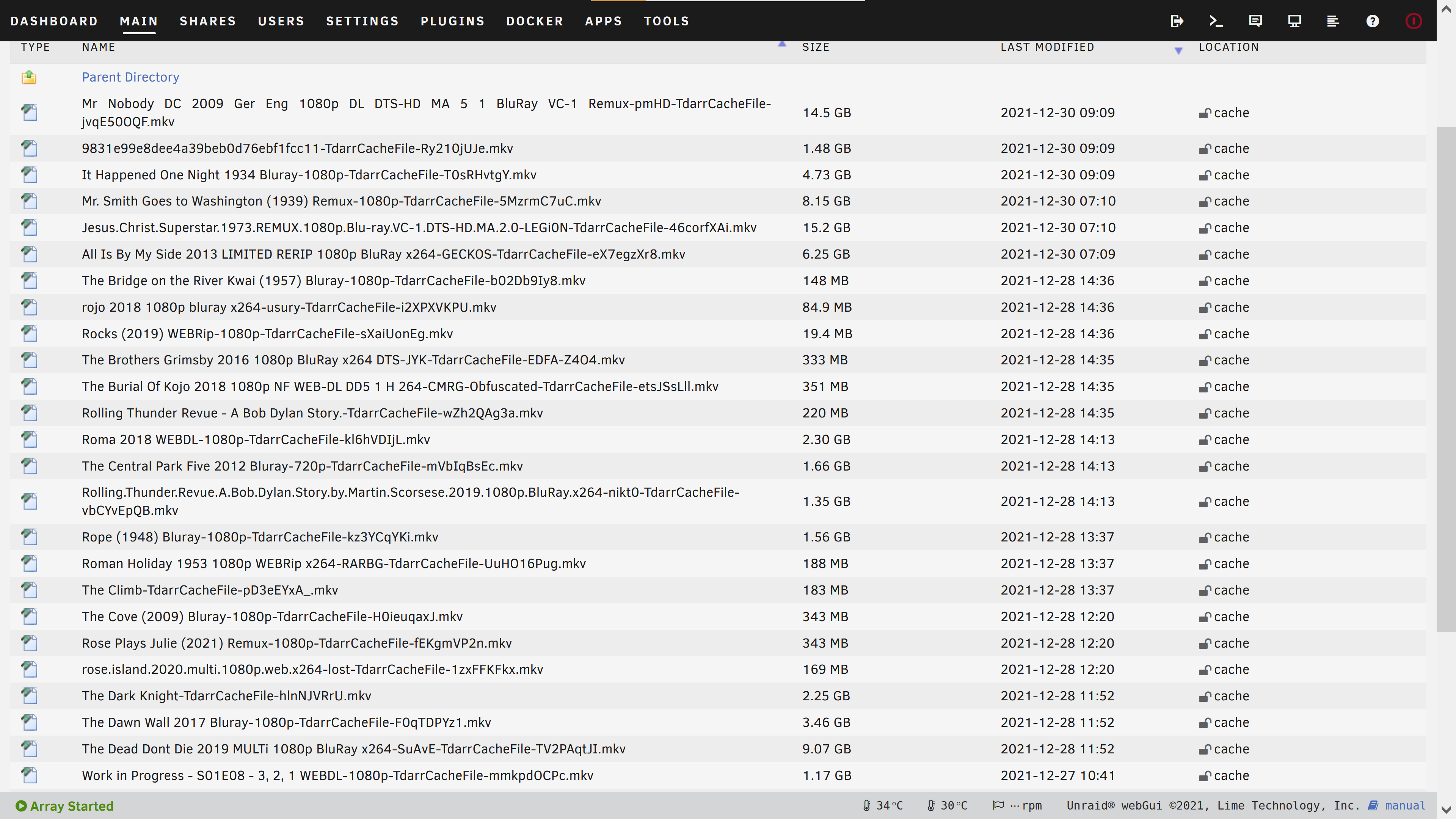

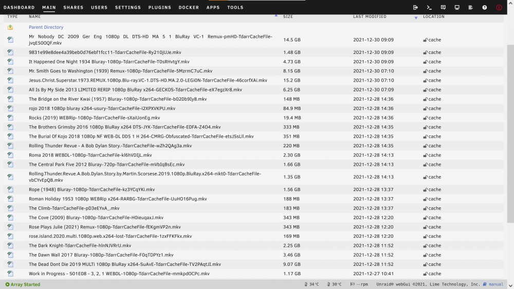

I've had no more unRaid server freezes, but there are numerous files on the cache drive that should have moved - they have dates of 27th and 28th December (screenshot attached). Should I move them manually?
