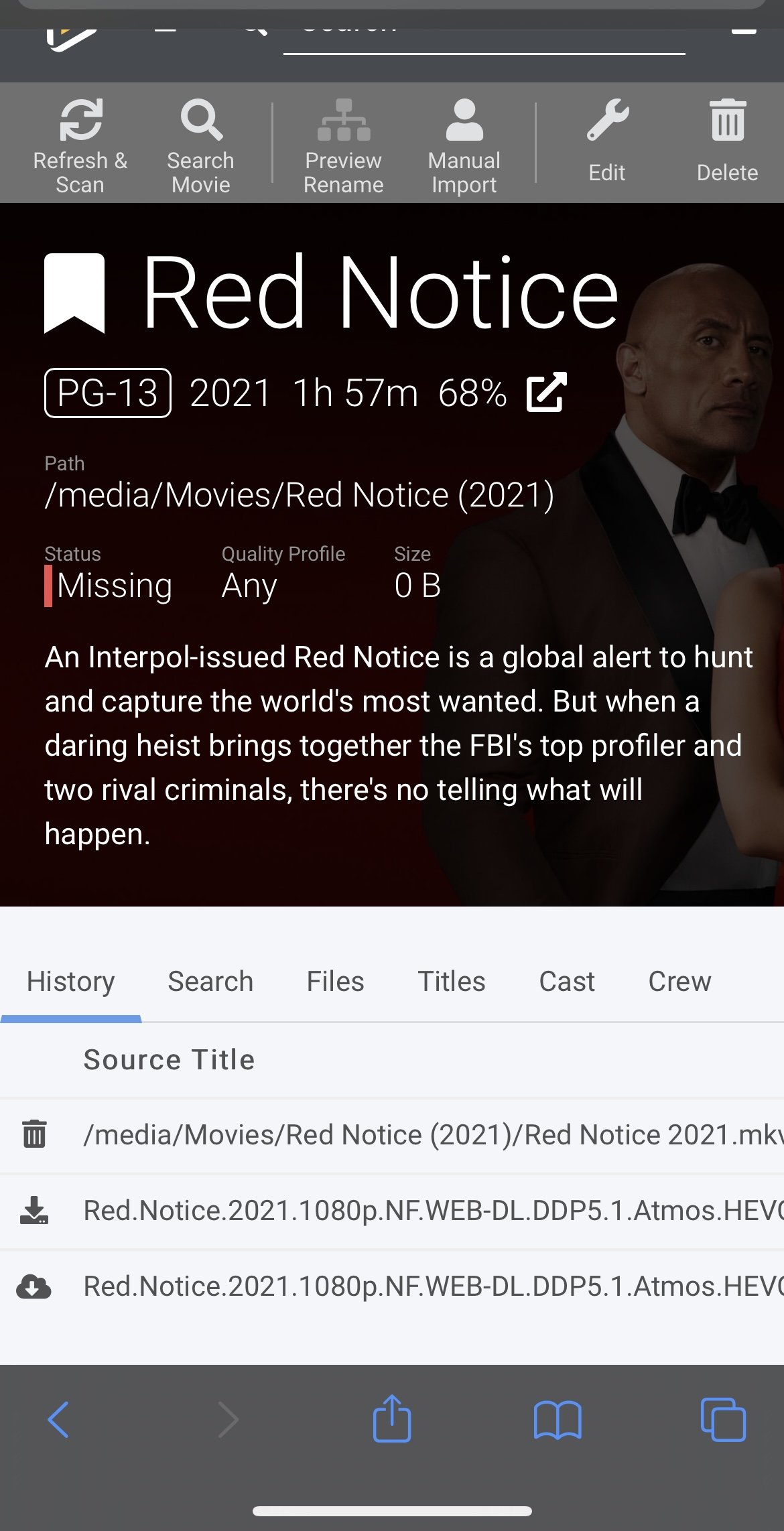

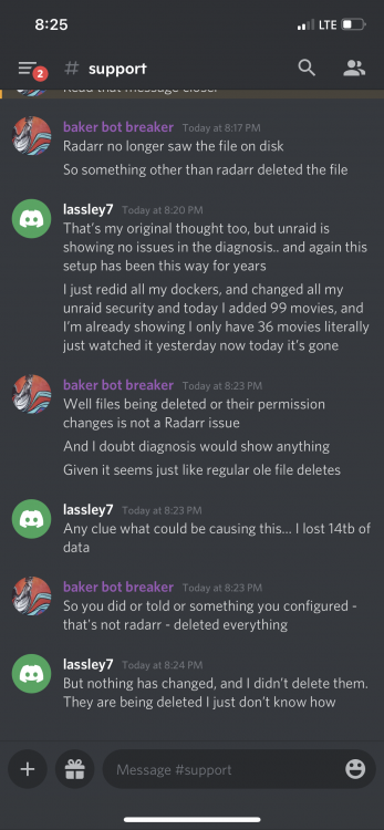

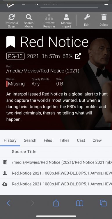

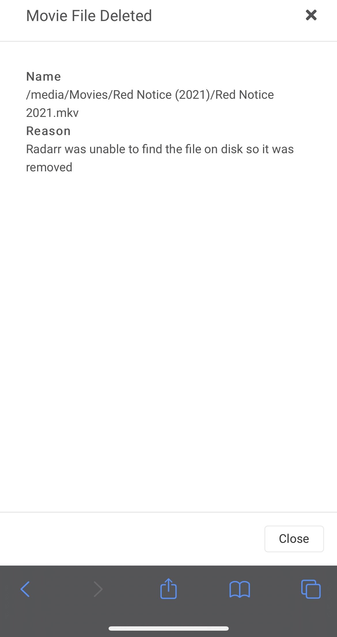

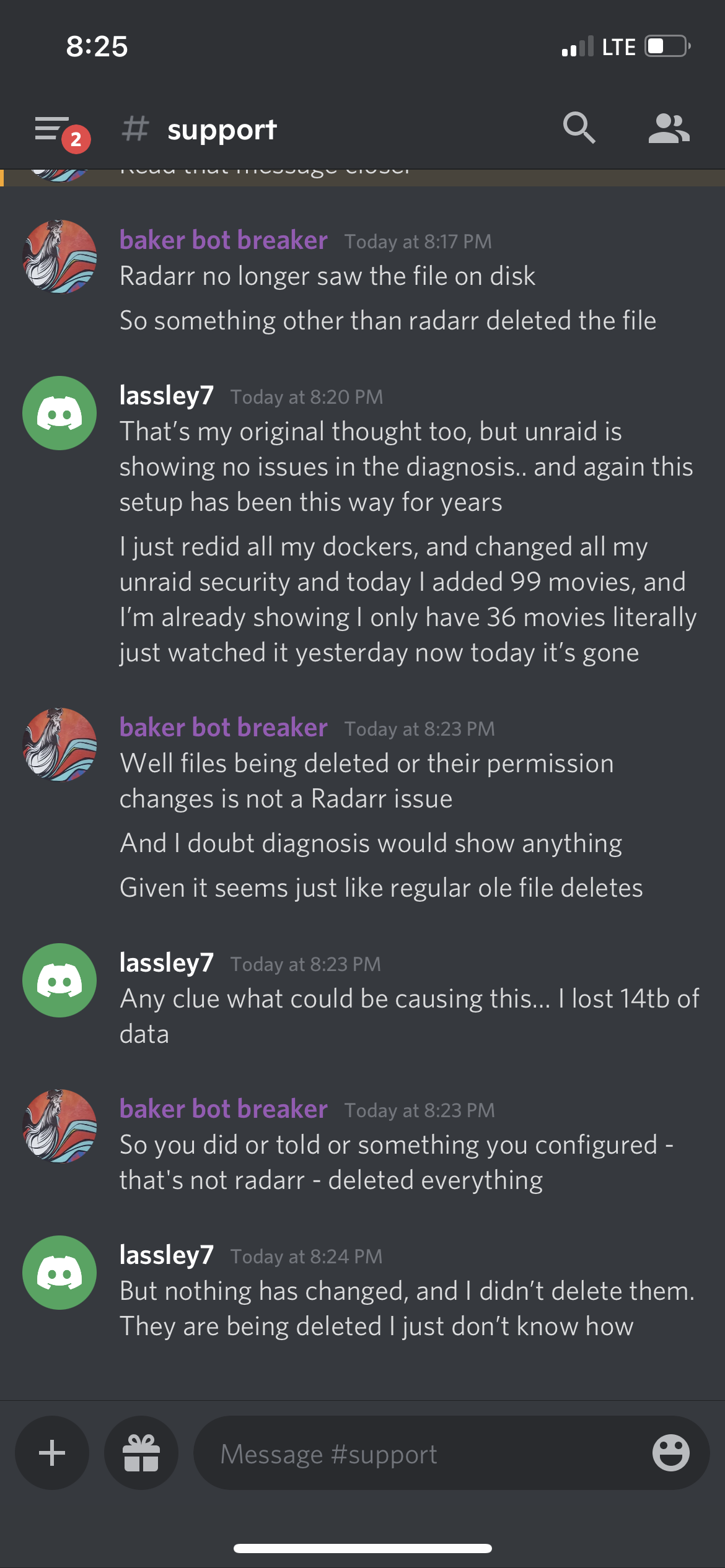

  23. This is my openvpn from my router, I disconnected my duckdns server “remote access” also so I just checked I went from having 99 “files” last night today I’m down to 36 “files” I have asked the radarr community and they said “something other then radarr is deleting the file as said above in the screen shot. So something is happening
  24. I have had my setup the same for years and just this past few days I lost all my media I took my server out of remote access changed all my passwords closed ports. Rechecked all my docker settings and last night I downloaded a few movies and today they did the same exact thing all my data “14tb” got deleted and now the few shows I added last night are gone can anyone help me figure this out? Radarr is reporting this poseidon-diagnostics-20211227-1909.zip
  25. So I did some digging today, and I found that my root paths in sonarr and radarr were changed to data/movies and not set to data/Movies when u changed this back it asked if I wanted to “delete files” so I’m wondering if I’m unfortunately another victim and someone got into my containers as I did have them all running through a duckdns domain. I have disabled all remote access to my server, I am going to add a few movies tonight, and see if they get deleted if they do. Do you or anyone else suggest what else to check? Ps I also changed server password, and container passwords.
