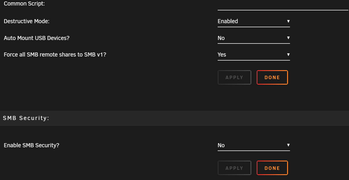

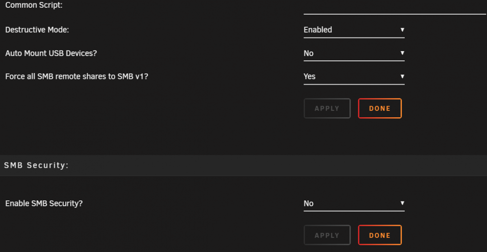

Not quite sure i follow.. I don't have SMB security enabled in UD settings, and I've never configured a username or password for SMB shares in UD which is why this log entry looks so strange to me. The exact same thing is happening on both of my servers.
Yes I've tried that several times but get the same result. Mar 31 08:56:38 Tower unassigned.devices: Removing configuration '//TOWERII/backupshare'. Mar 31 08:57:52 Tower unassigned.devices: Mount SMB share '//192.168.1.11/backupshare' using SMB1 protocol. Mar 31 08:57:52 Tower unassigned.devices: Mount SMB/NFS command: mount -t cifs -o rw,nounix,iocharset=utf8,_netdev,file_mode=0777,dir_mode=0777,sec=ntlm,vers=1.0,username='',password=******* '//192.168.1.11/backupshare' '/mnt/disks/TOWERII_backupshare' Mar 31 08:57:52 Tower unassigned.devices: Mount of '//192.168.1.11/backupshare' failed. Error message: username specified with no parameter
