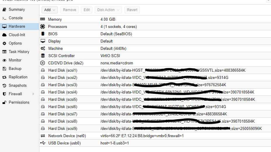

I hope that someone can help, I am trying to remove a SATA hard drive from my unraid environment to free up a SATA port for something else, so I have create a VM hard drive in Proxmox and pass this through to unraid. I have been able to preclear it with no issues, but for some reason I am no given the option to format it. I am on the latest version of preclear, but at the moment I am on version 6.11.1. any ideals ? I enclose a screen shot of my settings within proxmox and also a screen show from unraid.

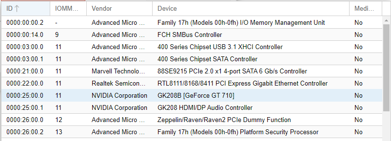

ok, by the look of it, I have a lot of devices on IOMM port 11. I will see if I can spilt them up into there own groups and then retry

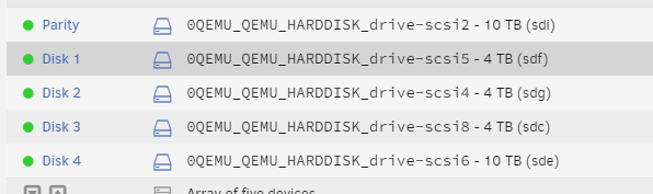

I have just moved my Unraid into Proxmox with little to no problems, but after the unraid finished rebuilding my Parity, I have discovered that I am not able to spin down my hard drivers within Unraid my current thinking - is that Unraid see them as Vm Hard disks and not a physical hard drive. all with default settings As may other people have done, I have pass through my Hard drivers as SCSI drivers, within proxmox Could my problem be that as I am passing through the Hard drives as SCSI's and not via a PCI controller that Unraid is not able to see the full hard drive details ? I did try and pass through a PCI controller but this just course unraid and proxmox to crash if I am wrong or you know how to fix this then please let me know, as I don't like having my disks spinning 24/7 when I don't need them to.

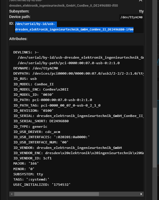

OK I have found the information - Thanks @SimonF but now here is the interesting bit. here is a screenshot of my information page. but when I go through the steps to set up my Zigbee Home Automation. it is failing, I will post my information and see if anyone can see my mistake and help me. here I am guesting results
Passthrough of ConBee II Zigbee USB Gateway to Home Assistant Virtual Machine
have a think moment - how did you get that window.
I had to update from 6.9 to 6.11 and I loss my ConBee device, I followed the steps, but I am still no able to connected. the steps I follow was to modify my VM Config by adding the following code but when I when to find /config/hardware within HA HACS I was not able to find it. where is it locate.

yes I do have a ad blocker for youtube, which I had turned off and retry, but still have then same issue. I have update my unraid to 6.11. and the problem is with my plugins has gone, the reason I was on 6.9 was because I was not able to pass through my ZigBee device into a VM Home Assistant. and now that issues has returned. 😞 Zigbee error within HA Error setting up entry ConBee II - /dev/serial/by-id/usb-dresden_elektronik_ingenieurtechnik_GmbH_ConBee_II_DE2496880-if00, s/n: DE2496880 - dresden elektronik ingenieurtechnik GmbH - 1CF1:0030 for zha Traceback (most recent call last): File "/usr/local/lib/python3.10/asyncio/tasks.py", line 456, in wait_for return fut.result() asyncio.exceptions.CancelledError The above exception was the direct cause of the following exception: Traceback (most recent call last): File "/usr/src/homeassistant/homeassistant/config_entries.py", line 357, in async_setup result = await component.async_setup_entry(hass, self) File "/usr/src/homeassistant/homeassistant/components/zha/__init__.py", line 112, in async_setup_entry await zha_gateway.async_initialize() File "/usr/src/homeassistant/homeassistant/components/zha/core/gateway.py", line 185, in async_initialize raise exc File "/usr/src/homeassistant/homeassistant/components/zha/core/gateway.py", line 172, in async_initialize self.application_controller = await app_controller_cls.new( File "/usr/local/lib/python3.10/site-packages/zigpy/application.py", line 138, in new await app.startup(auto_form=auto_form) File "/usr/local/lib/python3.10/site-packages/zigpy/application.py", line 118, in startup await self.connect() File "/usr/local/lib/python3.10/site-packages/zigpy_deconz/zigbee/application.py", line 92, in connect self.version = await api.version() File "/usr/local/lib/python3.10/site-packages/zigpy_deconz/api.py", line 451, in version (self._proto_ver,) = await self.read_parameter( File "/usr/local/lib/python3.10/site-packages/zigpy_deconz/api.py", line 416, in read_parameter r = await self._command(Command.read_parameter, 1 + len(data), param, data) File "/usr/local/lib/python3.10/site-packages/zigpy_deconz/api.py", line 301, in _command return await asyncio.wait_for(fut, timeout=COMMAND_TIMEOUT) File "/usr/local/lib/python3.10/asyncio/tasks.py", line 458, in wait_for raise exceptions.TimeoutError() from exc asyncio.exceptions.TimeoutError time to google the issue
