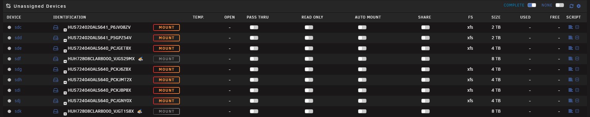

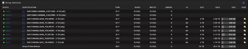

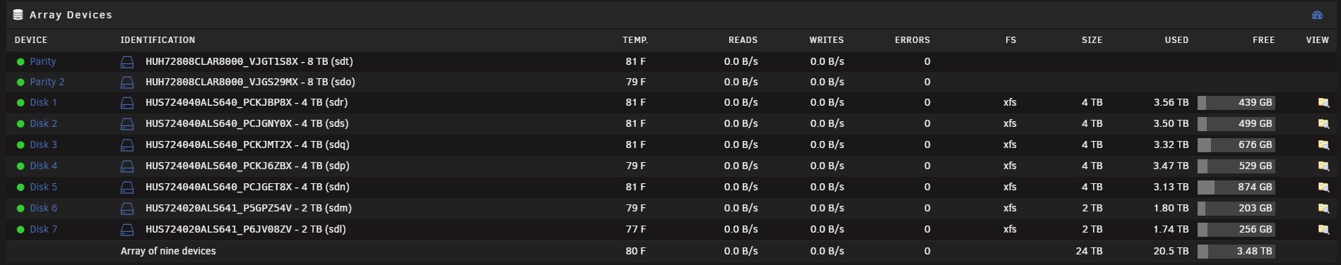

  8. I have a quick (hopefully) question/issue. I'm sure I'm just missing something, but UD shows my array devices as... well... Unassigned devices... Screen shots included, and hopefully self explanatory. The sd* identification is different between the two, but as you can see the HDD ID is the same.
