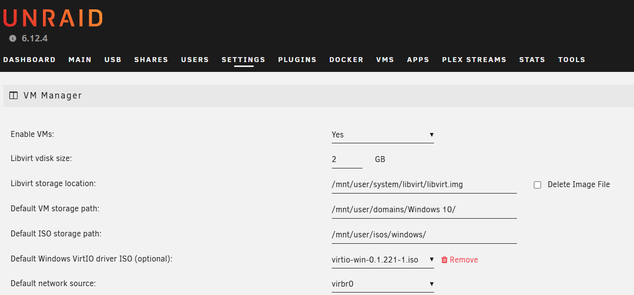

  1. Yes that is how I delete the file. I did that, disabled/enabled VM, and that's when I get this error. I also have lots of issues getting USB devices to work with the one W10 VM I have but I can't get the VM to start at the moment.
  2. Hello, I'm getting the same "Libvirt Service failed to start." message. This seemed as good as place as any to post this. If I'm wrong, please correct me. I deleted the libvert.img file, rebooted the server and I get this message. I rebooted because VMs were not working and I disabled/enabled the service but that did nothing. LIbvert storage location points to the .img file and the VM and ISO paths are legitimate. So I'm not sure what I'm missing. I've attached the diagnostics -- thank you for your help. tower-diagnostics-20241230-2017.zip

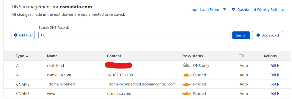

  8. Hello everyone, I'm a noob and trying to learn about setting up nextcloud on unraid. I've followed Spaceinvader's "Installing Nextcloud on Unraid 2022 pt1" to a tee and cannot get it to work. All the steps worked just fine except for setting up a CNAME in cloudflare - I am instead setting up a type A record and plugging in my static IP address. In my simple mind that should work. I've opened port 443 so I don't think that is the issue (I may be wrong though). My bigger question is this: I've been reading all the issues folks are running into regarding setup and nextcloud breaking after updates, etc. I would like to understand the need for cloudflare, what is going on in the background, what we actually need to set up remote access securely, etc. I know there are different methods of setting up nextcloud but what are the pros and cons with each? Are there any videos that describe this? Are there descriptions/recommendations on the unraid forums? I appreciate everyones support on this stuff, I have been using unraid for years and have been very happy, this forum has been very helpful.
