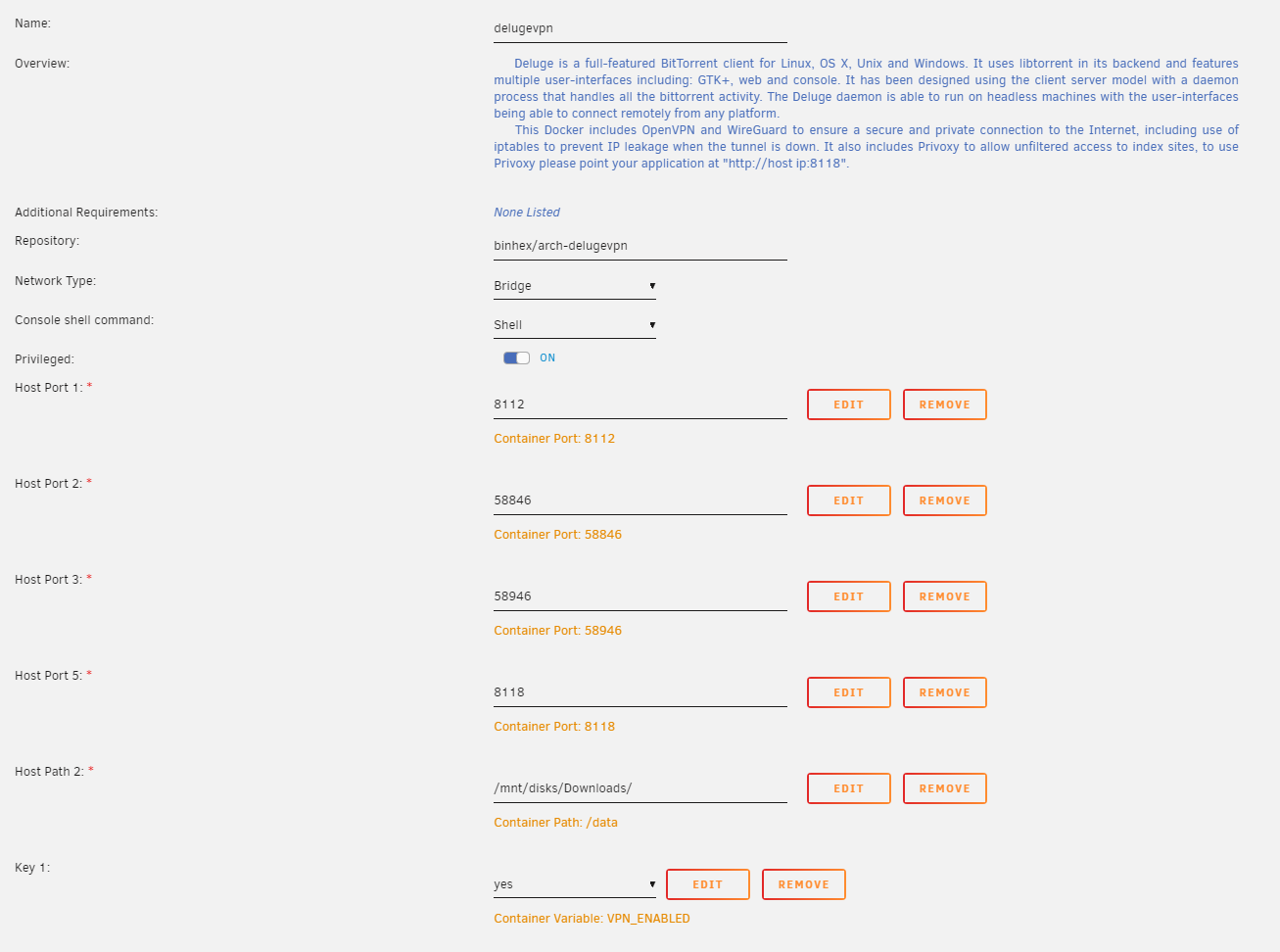

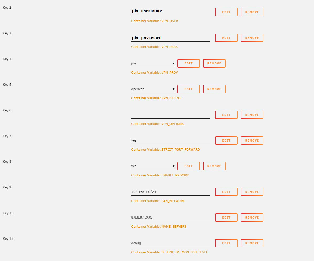

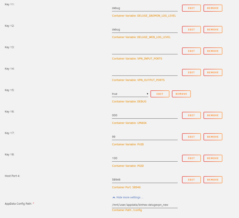

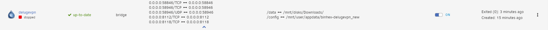

  2. After the most resent upgrade to unraid 6.11.1 my delugevpn container has been unable to display the web ui. When I disable the VPN from the container the WebUI does load. Couple things I've tried. DNS Updates, moved to 8.8.8.8,1.0.0.1 and other variations of cloudflare and google's DNS. Moved from TorGuard to PIA (PIA had a deal an my provide was charging more), this occured after the initial failure. My TorGUard subscription is still active but it produces the same results. Tried all the configuration OpenVPN files list on the link below. https://helpdesk.privateinternetaccess.com/kb/articles/where-can-i-find-your-ovpn-files Logs attached. This has worked since day 1 so I'm not really sure what broke the container. supervisord.log
