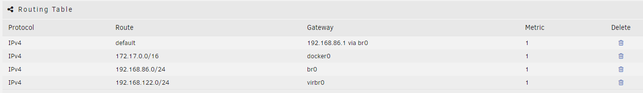

root@UnRaid:/usr/local/emhttp/plugins/unassigned.devices/include# /bin/ping -c 1 -W 1 DROBOSERVER ping: unknown host DROBOSERVER root@UnRaid:/usr/local/emhttp/plugins/unassigned.devices/include# /usr/bin/nmblookup DROBOSERVER 192.168.86.5 DROBOSERVER<00> 192.168.50.1 DROBOSERVER<00> Well that doesn't seem right. I know the 192.168.50.1 is the cable between the Drobo and the Network card that is only bound to the VM. the 192.168.86.5 is it's IP on my network, 192.168.86.4 is my UnRaid server. Hope this helps, thanks!

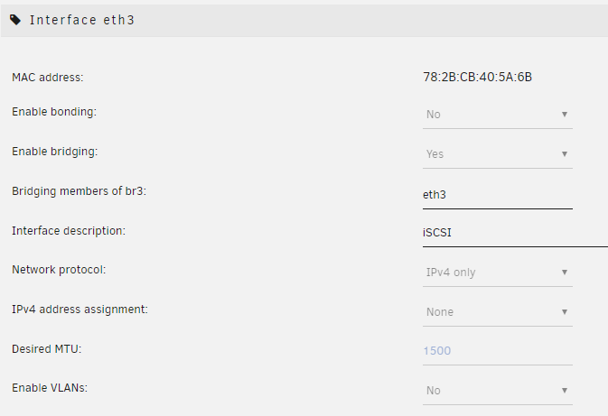

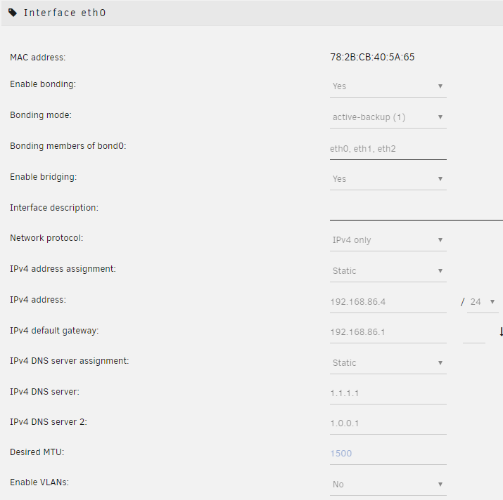

I have UnRaid 6.6.5 running on a Dell R710 server with 1 network card connected to my network and the other directly connected to a DroboElite for iSCSI. I have a Plex Docker container which needs to talk to the Drobo but since UnRaid doesn't support iSCSI I have a Windows 2016 VM setup in UnRaid as well. It has the following configuration and is working perfectly connecting to the internet, my intranet and to the iSCSI Drobo. Network Bridge 1 goes to my network and that's the card that has the IP is connect to to manage. 2nd Network card is bound to 1 card that is a cable between it and the DroboElite. I have that card passed through to the VM. Using the mount -cif
I have UnRaid 6.6.5 running on a Dell R710 server with 1 network card connected to my network and the other directly connected to a DroboElite for iSCSI. I have a Plex Docker container which needs to talk to the Drobo but since UnRaid doesn't support iSCSI I have a Windows 2016 VM setup in UnRaid as well. It has the following configuration and is working perfectly connecting to the internet, my intranet and to the iSCSI Drobo. Network Bridge 1 goes to my network and that's the card that has the IP is connect to to manage. 2nd Network card is bound to 1 card that is a cable between it and the DroboElite. I have that card passed through to the VM. Using the mount -t cifs command I am able to mount the Drobo fine from the terminal so I know all the networking is working and I am also able to add it to the docker container and Plex see the content and it works. It's just the unassigned devices I can't seem to get it mount the share. I use the buttons to populates the server and share and it finds everything ok but it doesn't mount. I have tried both with NFS and SMB shares. NFS it gives me the mount button but doesn't do anything. Log shows this error "nRaid unassigned.devices: Error: Remote SMB/NFS server '192.168.86.5' is offline and share '192.168.86.5://PlexMedia' cannot be mounted." when I try in mount it in the logs. Windows shows the NFS share as 192.168.86.5:/PlexMedia without the second / in it. Not sure if that matters. SMB has the mount button grayed out after adding it. I'm not sure where to go from here with making it work in the webgui. I really didn't want to have to manually do it in the terminal but I can. Thanks much!

I am not trying to be rude but almost every comment/suggestion I’ve gotten would have been answered if someone review the whole message thread. If you refer to the picture I posted on Wednesday you can see the mount button is grayed out. System is fully booted and I am just trying to mount a share.
I have confirmed that using mount -t cifs command from the terminal mounts the share just fine and I am able to successfully pass it to my Plex docker container without an issue. It appears that it's just an issue with unassigned devices.
