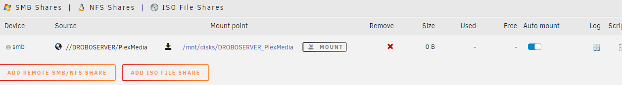

I am not trying to be rude but almost every comment/suggestion I’ve gotten would have been answered if someone review the whole message thread. If you refer to the picture I posted on Wednesday you can see the mount button is grayed out. System is fully booted and I am just trying to mount a share.

Upgraded to 6.6.5 and tried to readd the SMB share and this is what I get. I even click the "search for servers" and the "load shares" to confirm it was seeing everyting.
I have unRaid 6.6.3 and for the life of me I can't get Unassigned Disks to connect to SMB or NFS. My NFS share shows green bubble but when I click mount it fails. I hit the "Search for Server" button and selected the server and then hit "Load Shares" and selected the share. No Luck. As this share is on a Windows 2016 server I have also tried SMB but when I select server, put in admin creds for server, hit load shares, select share it gives me a gray dot next to smb and the "mount" button is gray and not orange. Any help would be greatly appreciated. Thanks! Nov 14 11:15:30 UnRaid unassigned.devices: Mount SMB/NFS command: mount -t nfs -o defaults '192.168.86.5://PlexMedia' '/mnt/disks/PlexMedia' Nov 14 11:15:30 UnRaid unassigned.devices: Mount of '192.168.86.5://PlexMedia' failed. Error message: mount.nfs: mounting 192.168.86.5://PlexMedia failed, reason given by server: No such file or directory Nov 14 11:16:15 UnRaid sudo: root : TTY=pts/1 ; PWD=/mnt/disks ; USER=root ; COMMAND=/usr/bin/chmod +777 PlexMedia/ Nov 14 11:16:20 UnRaid rpcbind[31397]: connect from 127.0.0.1 to getport/addr(status) Nov 14 11:16:20 UnRaid unassigned.devices: Mount SMB/NFS command: mount -t nfs -o defaults '192.168.86.5://PlexMedia' '/mnt/disks/PlexMedia' Nov 14 11:16:20 UnRaid unassigned.devices: Mount of '192.168.86.5://PlexMedia' failed. Error message: mount.nfs: mounting 192.168.86.5://PlexMedia failed, reason given by server: No such file or directory
