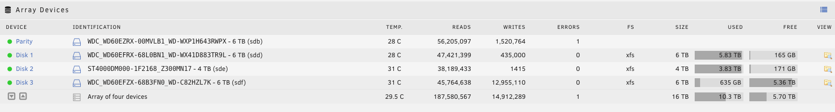

Hi, we had a brief blip in power the other night and the next day I noticed the server wasn't responding. When I log into the admin console I see the following message next to the parity drive (also says "wrong"), and the array is not started: "All existing data on this device will be OVERWRITTEN when array is Started". Please advise best course of action to resolve this. I'm hoping parity does not need to be rebuilt.
