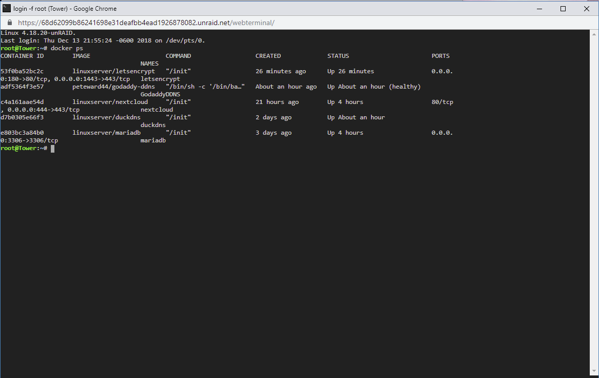

  3. After starting my letsencrypt I get the report that I included. Does the line in yellow about the kill signal affect anything? I am also working on trying to connect to my Nextcloud. I was able to connect to my nextcloud and then made the changes to be able to access it from the web and now I can't get into it. Keeps telling me error 522: connection timed out. I am guessing it has something to do with the reverse proxy or maybe port forwarding but I have no idea where to begin to troubleshoot. Tried to check and see and make sure that I had both ports 80 and 443 open. On one page it says that they are both open and on the next it shows that only port 80 is open. getting frustrated with taking one step forward and then seems like 3 steps back. Also If I can provide any additional information to try and help, please let me know.

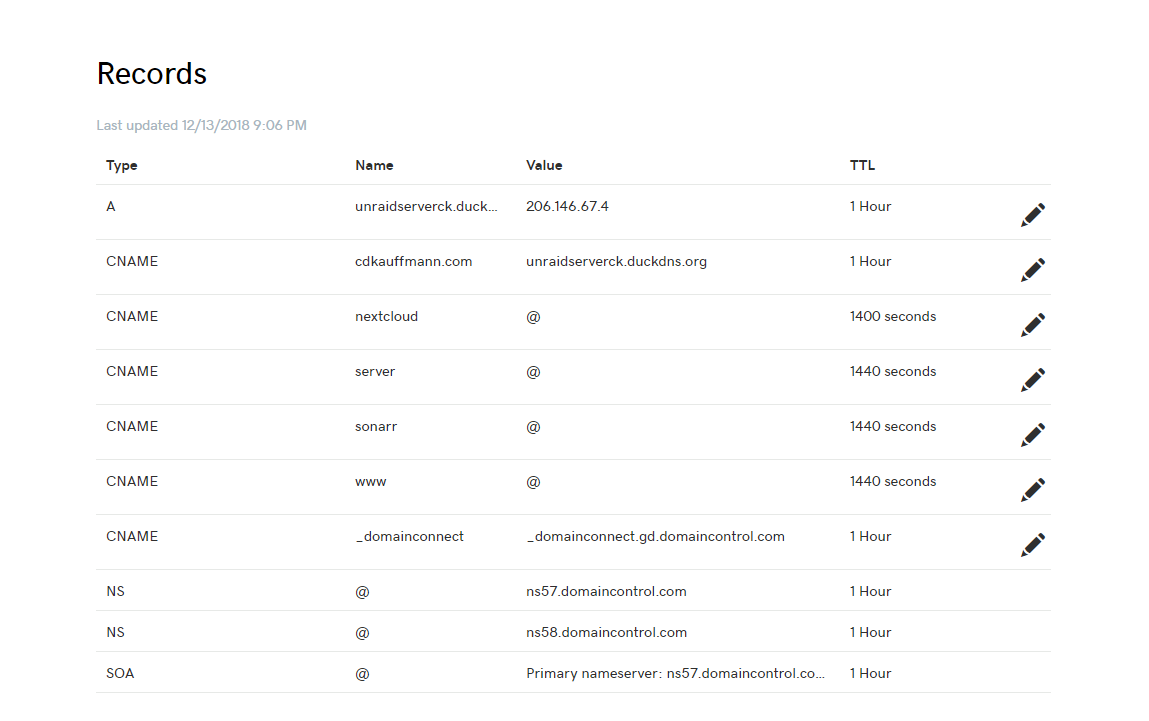

  6. cdkauffmann started following aptalca
  7. Do changes made on Godaddy go into effect right away or do I have to wait 24 hours? Still having problems and want to keep working on troubleshooting them but if it takes time for Godaddy, I don't want to start making more changes just to find out if I would have waited that everything was working.
  8. new to all this so it takes me a little bit. I use duckdns so I am guessing it would be dynamic. How would I tell if my domain is pointing to the correct address and/or make sure port forwarding is working? Are there some other screenshots I can take that would help you determine what the problem is? I am also getting my domain name from Godaddy, guessing that one of the dns records on their website is not set up correctly?
