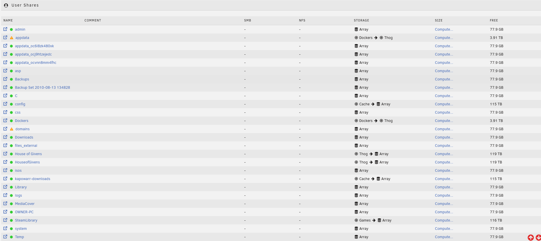

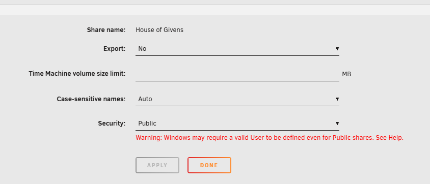

  2. testparm # Global parameters [global] bind interfaces only = Yes disable netbios = Yes disable spoolss = Yes interfaces = 192.168.1.63/24 fd52:29a3:e0fd:2001:d250:99ff:fedc:5611/64 127.0.0.1 ::1 load printers = No logging = syslog@0 map to guest = Bad User max open files = 40960 multicast dns register = No ntlm auth = ntlmv1-permitted null passwords = Yes passdb backend = smbpasswd printcap name = /dev/null security = USER server min protocol = SMB2 server signing = if_required server string = show add printer wizard = No smb1 unix extensions = No fruit:nfs_aces = No idmap config * : range = 3000-7999 idmap config * : backend = tdb acl allow execute always = Yes aio read size = 0 aio write size = 0 create mask = 0777 directory mask = 0777 hide dot files = No include = /etc/samba/smb-shares.conf invalid users = root use sendfile = Yes wide links = Yes [flash] comment = Unraid OS boot device force user = root guest ok = Yes map archive = No map readonly = yes path = /boot read only = No vfs objects = catia fruit
  3. It didn't seem to be an issue so far. I just had a specific drive dockers.
  4. I booted in Safe mode. Still having the same issue. What is testparm? houseofgivens-safemode-diagnostics-20250828-1520.zip
  5. Here is an updated diagnostic report.houseofgivens-diagnostics-20250828-0649.zip
  6. I do have some situated as you say. Most of them are in the app data. This had not been an issue until after the update.
  7. All the shares show up in the tab. The only share that shows up when I look for it on the network is the flash drive. At one point I was able to see more but that dwindled down to just the flash drive. At one point I was able to see more of the shares but that dwindled down until the only one I can see is the flash boot drive. All of them are visible in the shares tab.
  8. houseofgivens-diagnostics-20250827-2128.zipI updated Unraid and everything was fine for a while. Then my SMB shares vanished. I disabled NFS, and Host access in Dockers..no joy. Please assist.
