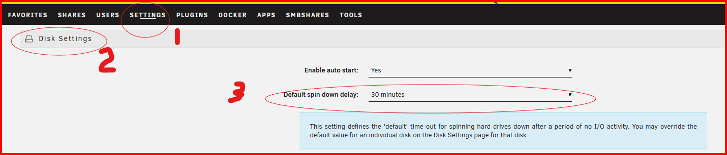

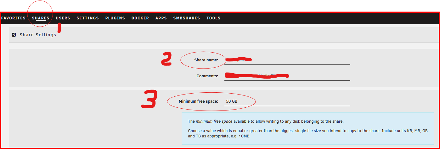

Try going here: Set that #3 value to a reasonable value based on the largest file you will be transferring to that share.
Error writing to a Share

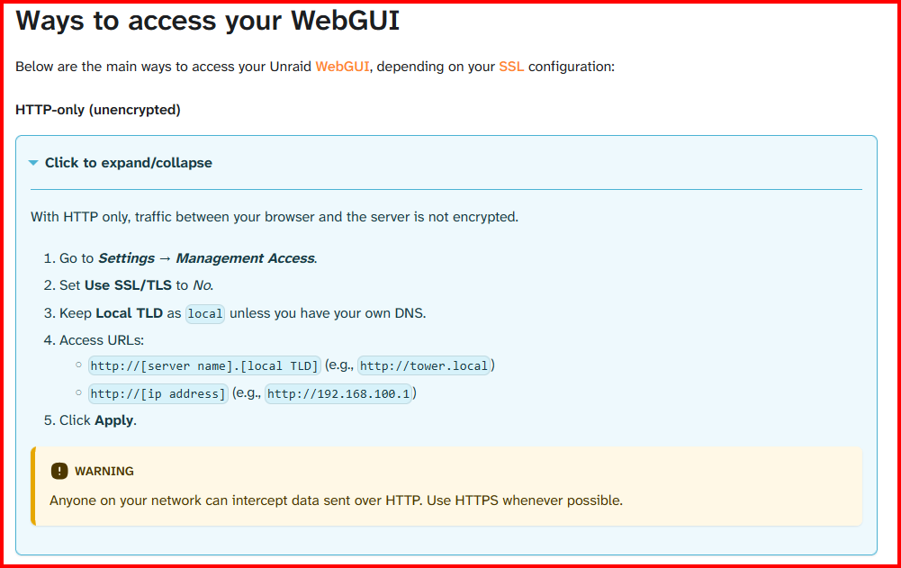

I looked at your Diagnostics and you have set the 'Use SSL/TLS:" parameter to 'No'. From this setting, this is what the docs have to say: (https://docs.unraid.net/unraid-os/system-administration/secure-your-server/securing-your-connection/#ways-to-access-your-webgui)

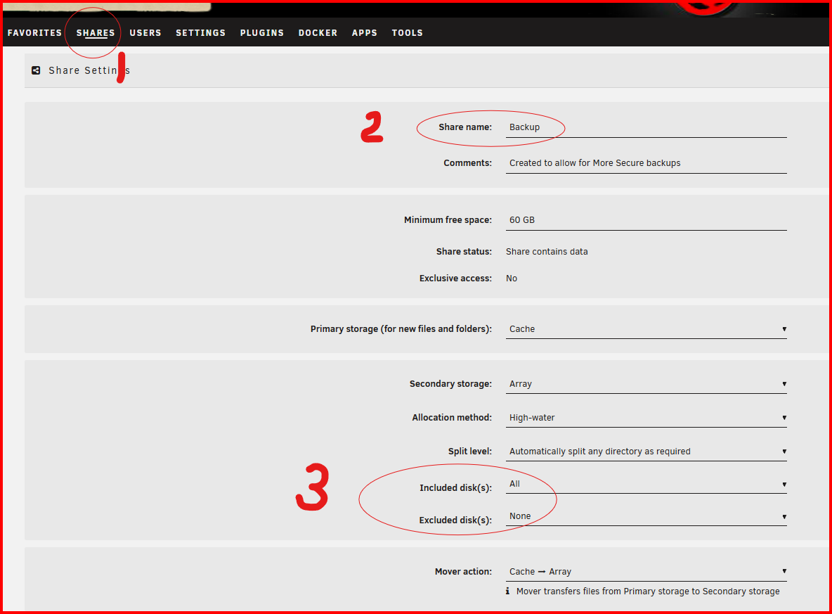

In the User Share Setting: First Shares from GUI. Then chose the User Share (2). Then (3) using "Include disk(s):" or "Excluded disk(s):" (NOT both!) to chose where the files are to be placed.
