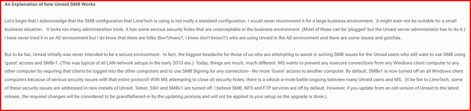

If you want more information on how SMB works and setting SMB access to your Unraid server, have a look at this thread: https://forums.unraid.net/topic/191221-some-musings-on-smb-and-samba-and-unraid-and-windows/ Not only those 'guys' but anyone else who might gain access to your server via a 'guest' login. You can gain access as a 'guest' to your Unraid server by just entering a bad user name in the login prompt for share access. The only improvement on security from 'Public' is that they don't have write access. Remember that 'read' access also means copy permissions!

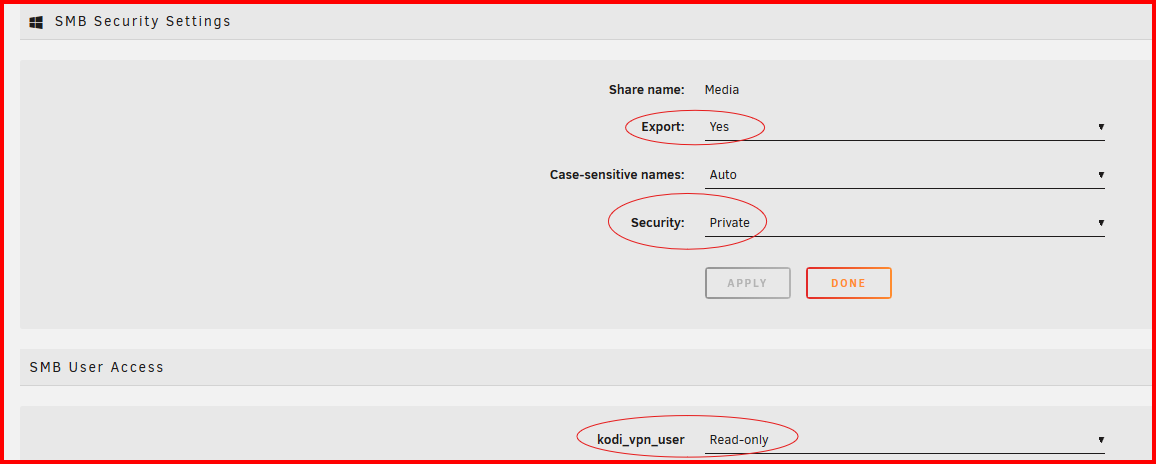

I have mine set up to use the tailscale IP address as shown below: Note that you have to use \\{IP_Address} Than I have all my share setup to Private. I have assigned a special user for those you I permit to access my shares using Tailscale. I use Credential Manager to actually log in this user. See Below: You do have to go to SHARES >>>> Share_name >>>Share Settings on your Unraid server and actually grant permissions for this user to access the share. See below:

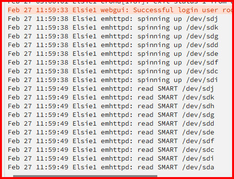

I am not so sure about that.. I just spun up the disks on my array and it appeared to happen is less then three to four seconds. (I was hitting the refresh on the browser.) Here is the log: I don't see any indication of any delay... I do know that there is a straggled delay if you are doing a directory scan/search on a User Share that covers multiple disks but there seems to be times when all disk are spun up simultaneous (or close to it.)

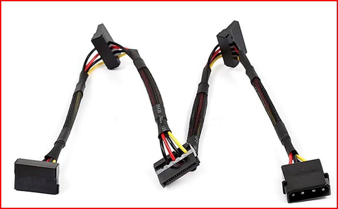

The biggest worry with the MOLEX connector is the IR drop during startup. This can be compounded if they are in series. Probably a good rule would be two MOLEX/SATA connectors in series. And don't even talk about SATA power connectors. That design is the poster child for how not to design a connector! I don't even think using a SATA-to-SATA splitter is a good idea in a server environment. This is the ideal design for a MOLEX-to-SATA power splitter: Notice that there is a max of 4 SATA connectors. Also observe that the wire is continuous and the connection is made by displacing the insulation with a blade on the terminal in each connector. (Avoid molded in wires as defective manufacture of the cable can result in a known fire hazard!) This should be plugged directly into a MOLEX connector on the +12V cable from the PS.
