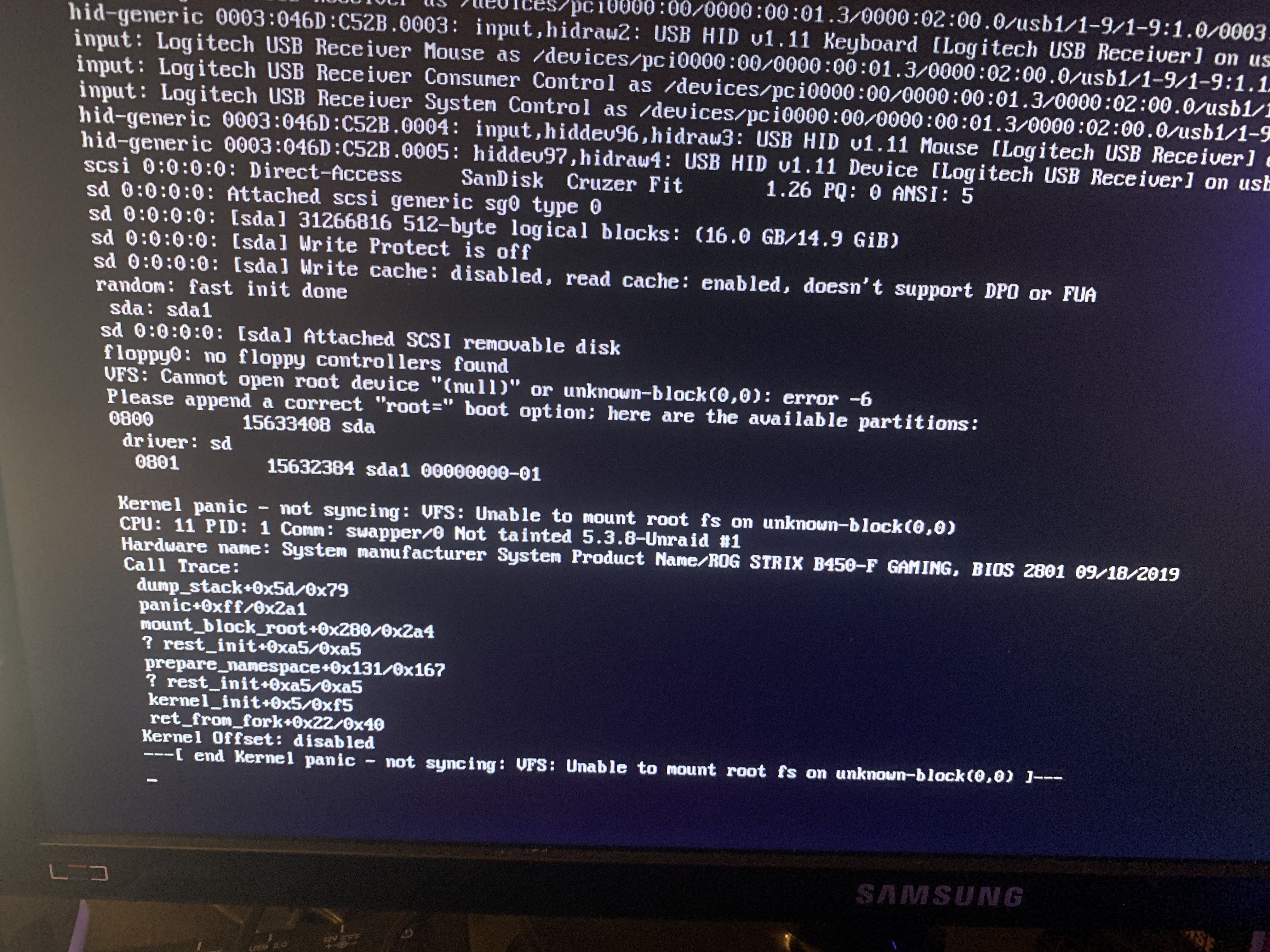

  3. It just crashed again here is a screenshot of the last page

  5. I dont have a Screen Shot. A Kernel panic is the warning I received when I plugged my monitor in to the GC and the boot halted. It basically means that the kernel was unable to load for some reason. I did get the problem fixed by copying all of my usb data to another computer and reinstalled from unraid the os then copied my config to the usb I am back up and running but I still have the orginal unassigned devices error
  6. I tried rebooting after closing everything and now im having a kernal panic and can't boot in to unraid in any way
