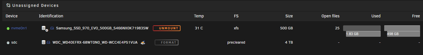

  9. Yeah, the other displays for array, cache, and boot are showing properly. I'm fairly certain the 2019.01.21a version of UD was also showing properly PS. I'm on Unraid 6.6.6 if that helps
  10. That screenshot was Chrome (v. 71.0.3578.98). I also just checked on Firefox (v. 64.0.2). It looks the same as in Chrome
  11. So does mine. I'm on 2019.01.22 with the Black theme enabled as well
