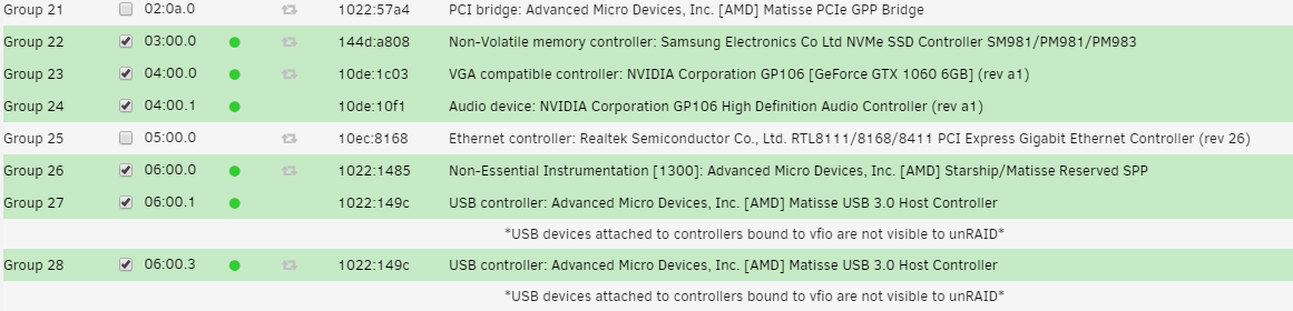

I am using a Asus tuf x570-plus motherboard but the IOMMU-groups seams to be identical. After reading the whole thread I have placed the unraid usb on the 0b:00.3 USB controller. I have also passed 06:00.1, and 06:00.3 controllers using the VIFO-PCI plugin. My Windows 10 VM is using 06:00.1 and it works perfectly. But I have not got my other VM's to be able to use the 06:00.3 controller as nothing happens when I plug anything in the ports. I am not sure which ports is connected to 06:00.3 but I have tried all ports on my unraid server. Or is it connected to the single USB-C connector ? Do I also need to pass through: Group 26 06:00.0 1022:1485 Non-Essential Instrumentation [1300]: Advanced Micro Devices, Inc. [AMD] Starship/Matisse Reserved SPP Edit: passing through Group 26 did not change anything. When looking in the log for the other VM I get this: 2020-03-11T16:02:11.664422Z qemu-system-x86_64: vfio: Cannot reset device 0000:06:00.0, depends on group 27 which is not owned.
