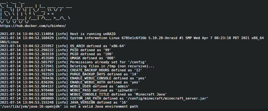

  13. Hi, I'm on the 6.9.2 version of Unraid, I have had the minecraft serverworking previously but it stopped after I updated the docker today. I can't get the webui to open either, it just says it can't connect. The last line in the docker log is '/usr/lib/jvm/java-16-openjdk' is not a valid Java environment path. I force updated the container to see if it would fix it, but still getting this. Any ideas?
