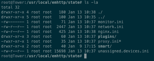

  1. Thanks, that seems to have been the key. Any idea how that could have ended up empty? Also, I'm assuming you saw that it was empty in diagnostics/config/go.txt?
  2. Hi all, I just upgraded to Unraid 7, which went fine until rebooting. After rebooting, I'm no longer able to access the GUI, I instead get an HTTP 500 error from Nginx. I'm still able to SSH in, so I ran /etc/rc.d/rc.php-fpm restart to restart PHP, and now I'm able to access the login screen. But as soon as I login, I'm back to an HTTP 500. Contents of /var/log/nginx/error.log: 2025/01/13 10:38:29 [crit] 8341#8341: *1 connect() to unix:/var/run/php-fpm.sock failed (2: No such file or directory) while connecting to upstream, client: 192.168.200.139, server: , request: "GET /Main HTTP/1.1", subrequest: "/auth-request.php", upstream: "fastcgi://unix:/var/run/php-fpm.sock:", host: "192.168.200.82" 2025/01/13 10:38:29 [error] 8341#8341: *1 auth request unexpected status: 502 while sending to client, client: 192.168.200.139, server: , request: "GET /Main HTTP/1.1", host: "192.168.200.82" 2025/01/13 10:38:29 [crit] 8341#8341: *3 connect() to unix:/var/run/php-fpm.sock failed (2: No such file or directory) while connecting to upstream, client: 192.168.200.139, server: , request: "GET /favicon.ico HTTP/1.1", subrequest: "/auth-request.php", upstream: "fastcgi://unix:/var/run/php-fpm.sock:", host: "192.168.200.82", referrer: "http://192.168.200.82/Main" 2025/01/13 10:38:29 [error] 8341#8341: *3 auth request unexpected status: 502 while sending to client, client: 192.168.200.139, server: , request: "GET /favicon.ico HTTP/1.1", host: "192.168.200.82", referrer: "http://192.168.200.82/Main" 2025/01/13 10:38:46 [crit] 8341#8341: *5 connect() to unix:/var/run/php-fpm.sock failed (2: No such file or directory) while connecting to upstream, client: 192.168.200.139, server: , request: "GET /Main HTTP/1.1", subrequest: "/auth-request.php", upstream: "fastcgi://unix:/var/run/php-fpm.sock:", host: "192.168.200.82" 2025/01/13 10:38:46 [error] 8341#8341: *5 auth request unexpected status: 502 while sending to client, client: 192.168.200.139, server: , request: "GET /Main HTTP/1.1", host: "192.168.200.82" 2025/01/13 10:46:51 [crit] 8341#8341: *15 connect() to unix:/var/run/php-fpm.sock failed (2: No such file or directory) while connecting to upstream, client: 192.168.200.139, server: , request: "GET /Main HTTP/1.1", subrequest: "/auth-request.php", upstream: "fastcgi://unix:/var/run/php-fpm.sock:", host: "192.168.200.82" 2025/01/13 10:46:51 [error] 8341#8341: *15 auth request unexpected status: 502 while sending to client, client: 192.168.200.139, server: , request: "GET /Main HTTP/1.1", host: "192.168.200.82" 2025/01/13 10:46:53 [crit] 8341#8341: *17 connect() to unix:/var/run/php-fpm.sock failed (2: No such file or directory) while connecting to upstream, client: 192.168.200.139, server: , request: "GET /Main HTTP/1.1", subrequest: "/auth-request.php", upstream: "fastcgi://unix:/var/run/php-fpm.sock:", host: "192.168.200.82" 2025/01/13 10:46:53 [error] 8341#8341: *17 auth request unexpected status: 502 while sending to client, client: 192.168.200.139, server: , request: "GET /Main HTTP/1.1", host: "192.168.200.82" 2025/01/13 10:55:31 [crit] 8341#8341: *28 connect() to unix:/var/run/php-fpm.sock failed (2: No such file or directory) while connecting to upstream, client: 192.168.200.139, server: , request: "GET /Main HTTP/1.1", subrequest: "/auth-request.php", upstream: "fastcgi://unix:/var/run/php-fpm.sock:", host: "192.168.200.82" 2025/01/13 10:55:31 [error] 8341#8341: *28 auth request unexpected status: 502 while sending to client, client: 192.168.200.139, server: , request: "GET /Main HTTP/1.1", host: "192.168.200.82" 2025/01/13 10:55:33 [crit] 8341#8341: *30 connect() to unix:/var/run/php-fpm.sock failed (2: No such file or directory) while connecting to upstream, client: 192.168.200.139, server: , request: "GET /Main HTTP/1.1", subrequest: "/auth-request.php", upstream: "fastcgi://unix:/var/run/php-fpm.sock:", host: "192.168.200.82" 2025/01/13 10:55:33 [error] 8341#8341: *30 auth request unexpected status: 502 while sending to client, client: 192.168.200.139, server: , request: "GET /Main HTTP/1.1", host: "192.168.200.82" 2025/01/13 11:06:23 [crit] 8341#8341: *43 connect() to unix:/var/run/php-fpm.sock failed (2: No such file or directory) while connecting to upstream, client: 192.168.200.139, server: , request: "GET /Main HTTP/1.1", subrequest: "/auth-request.php", upstream: "fastcgi://unix:/var/run/php-fpm.sock:", host: "192.168.200.82" 2025/01/13 11:06:23 [error] 8341#8341: *43 auth request unexpected status: 502 while sending to client, client: 192.168.200.139, server: , request: "GET /Main HTTP/1.1", host: "192.168.200.82" Based on PHP logs there may be some sort of issue with one of the dynamix scripts: [13-Jan-2025 11:07:56 America/New_York] PHP Fatal error: Uncaught TypeError: date(): Argument #2 ($timestamp) must be of type ?int, string given in /usr/local/emhttp/plugins/dynamix/template.php:54 Looking at that script, it appears that it's trying to include several ini files from /usr/local/emhttp/state: However, none of those files seem to exist on my system (or I'm looking in the wrong place): Diagnostics are attached. Any help or advice is welcome. tower-diagnostics-20250113-1118.zip

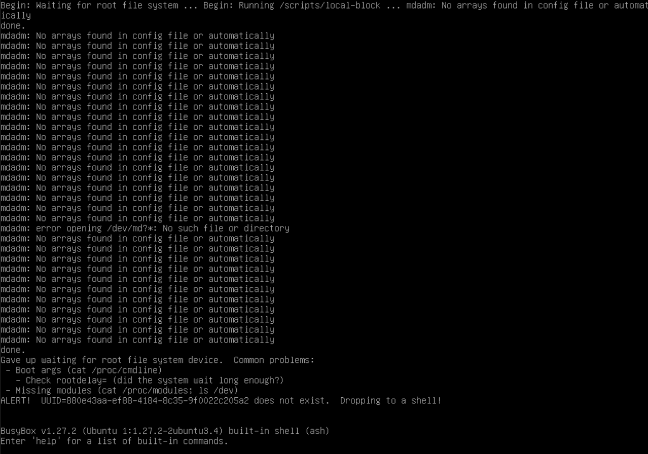

  3. Hi all, I have an Ubuntu VM running my unifi controller, which is set to auto start. When I rebooted after the upgrading to 6.12, my browser wouldn't load the GUI, so I thought there was an issue, and hard power cycled (it turns out Firefox had "conveniently" redirected me to https). In any case, I'm thinking that the hard power cycle did something to the vdisk for the VM. In the VNC console, I see a bunch of fairly standard looking output, and then it starts complaining about waiting for local filesystem, and a repeated "madm: No arrays found in config file" error. And then it dumps me to a budybod initramfs terminal. In the VM, the command ls /dev/disk/by-id displays only the QEMU DVD drive. I've tried using ddrescue and qemu-img convert to repair the disk, but to no avail. I've attached a screenshot of end state of the terminal window of the VM logs. Any advice would be welcome. unifi logs.rtf
