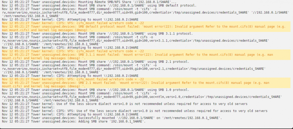

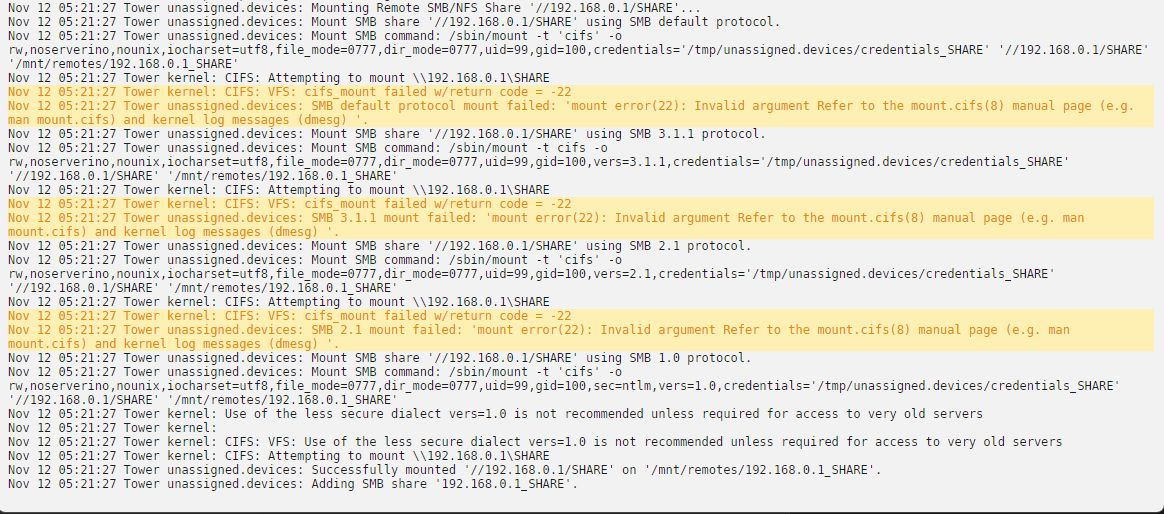

This is my other unraid-server - here it works - seems like SMB1.0 (i know...) PS: I have Auto-Update on this server also activated - and it is already up to date (the UD plugin) - but i didn't reboot this server since 7 days. Do the updatet versions only get active after a reboot? I didn't know that...

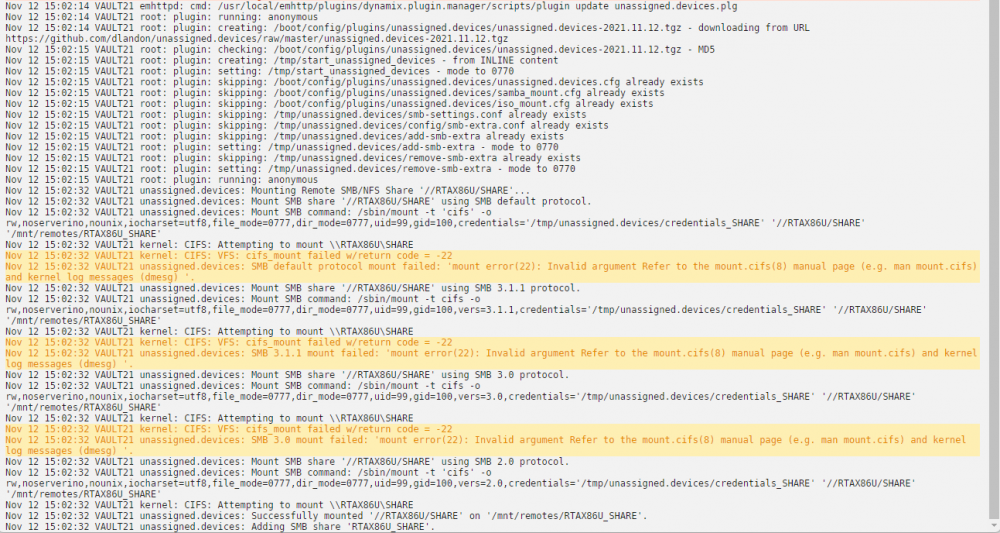

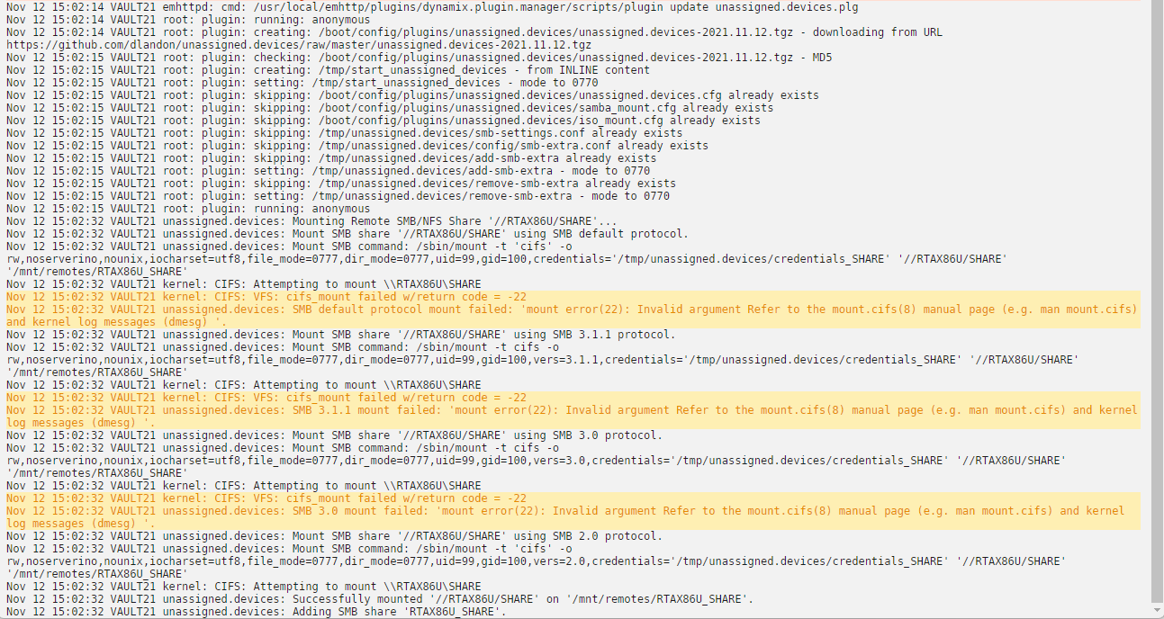

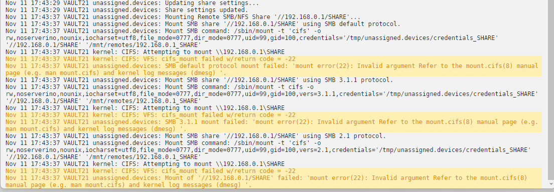

Hi - I have a strange problem. Today is restartet my server for installing a new HDD - and after the restart my ASUS AX86U SMB-Share doesn't connect anymore - nothing changend on my site - i had it connected all the time - i just updated the UD regulary (but never re-connected) I get following messages: In the release notes there is some change with SMB?! I already did a new SHARE - no help, did the connect-test with another PC - it's ok and works... I don't understand Please can anybody help here? Is this a bug? best regards
