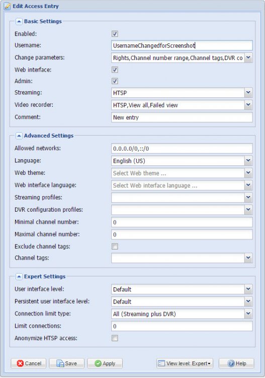

  5. I created an Admin account, and I'm using that account to login I wanted to add, I just added the Kodi Plugin, and used the admin credentials and it's streaming, so I did something right. But can't stream via the web.

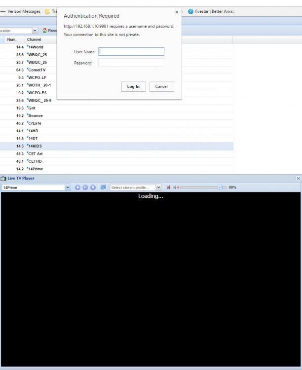

  6. Sorry let me elaborate, If I try to access it via Port 9982 it says Site can't be reached. I can login and authenticate via port 9981, then if I click Watch TV, it opens a new windows and it gives the screenshot attached. If I select a channel, I get the Authentication Required (screenshot attached) I try to login using admin credentials, and it just keeps asking to login. Not sure what you mean by play button, unless you're referring to recording. I haven't bothered to test that yet till I'm able to stream. I've attached updated log file Edit: I wanted to add, I just added the Kodi Plugin, and used the admin credentials and it's streaming, so I did something write. But can't stream via the web. TVheadendLog.txt

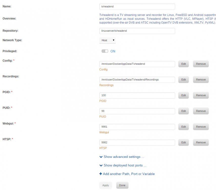

  7. Hi All, Just installed this docker, I followed the read me, but I'm having issues. I'm using HDHomerun, I ran through the wizard, I believe I got my EPG setup correctly, but when I try to watch a show via the Web interface, it constantly asks me to login, and then gives me a 401 unauthorized. I'm also trying to get this working with Kodi PVR. Is there a direct way to access the log file or enable debugging besides accessing it through the unraid web interface? Thanks tvheadend.txt

  9. Hi, I just installed this and followed the instructions, but in the docker log, all it says is: We are now refreshing packages from apt repositorys, this *may* take a while I've left it running for an hour and no change. When I try to connect to the docker via the web, no surprise I get a connection Refused. I deleted it and tried it again and the same thing. Can anyone point me in the right direction to troubleshoot this? Thanks
