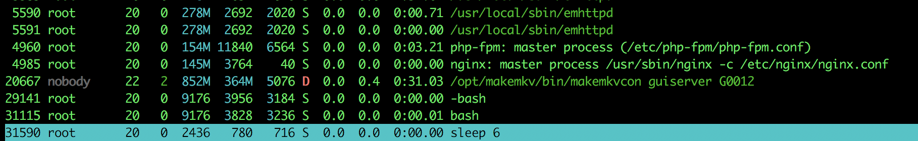

  13. I checked my docker image and I have plenty of space. I have a 100gb file. I've been able to re-produce this a few times now. When I have a disc that has a scratch on it and it is unable to copy successfully, MakeMKV keeps ticking up in time till completion. I then try and stop the copy in MakeMKV and then try and stop the container and am unable to. I can then go into htop and search for the container id and kill it. After that is killed, I can remove the container and re-add it, however there is still a process that has a signal D and is waiting for the drive. I am unable to kill that process regardless of Sigterm/Sigkill. You can see in the screenshot process 20667 that can not be killed which is hanging up the system from stopping the array/rebooting/shutting down/etc... Any thoughts on how to make sure this doesn't happen if a disc doesn't copy successfully?
