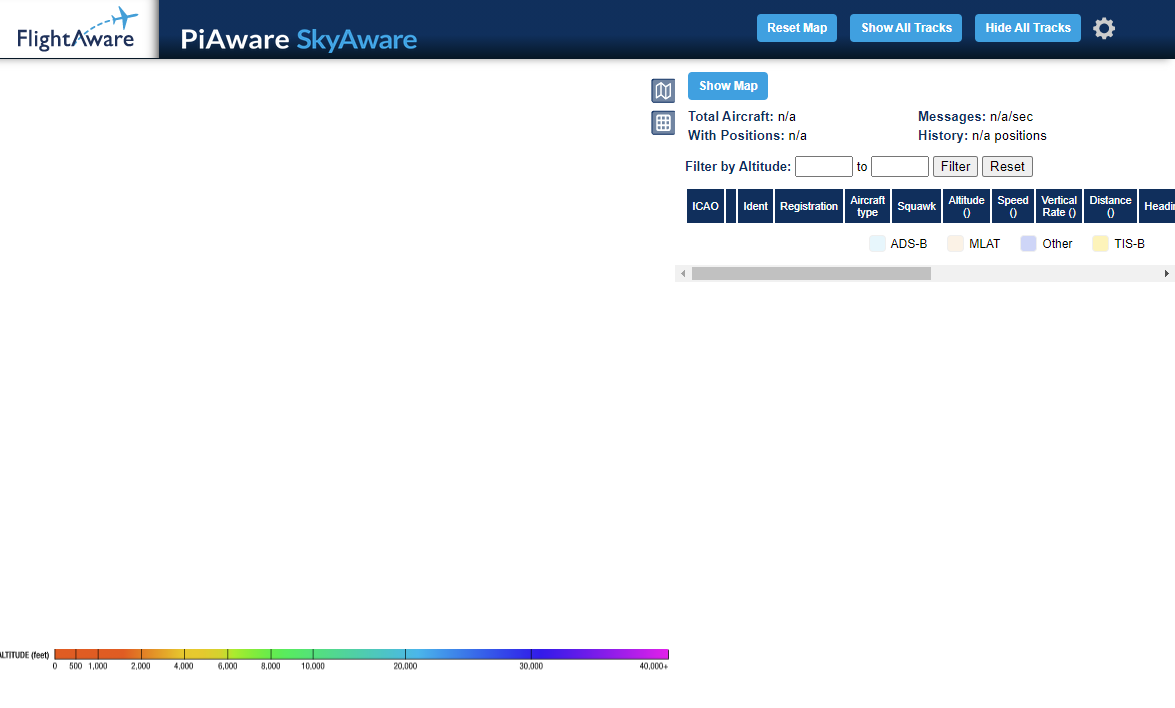

  9. I am having the same issue... I can get to the page still but it looks like this, and does not function.
