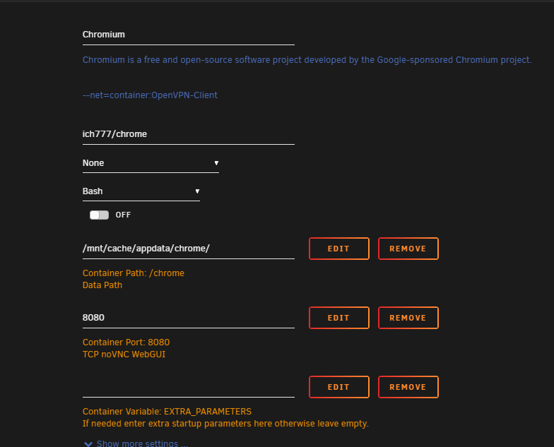

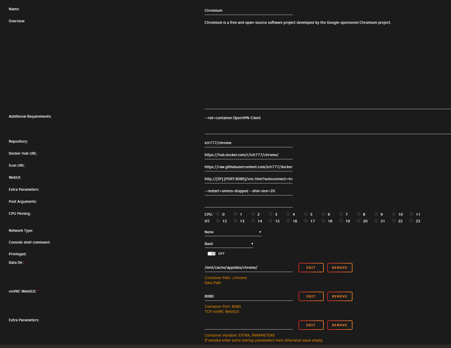

  1. yes, that is correct. I can't connect to http://192.168.2.242:8080/vnc.html?autoconnect=true here is the advanced configuration
  2. I'm still trying to make this work without any success. I decided to try to make it work with Chromium just to try to get it working and then I would go from there. Here is my configuration for Chromium I've been trying for days to get this resolved and I can't understand what I'm doing wrong.

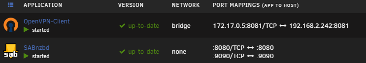

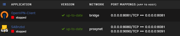

  3. I am trying to get OpenVPN-Client working and I can't seem to get the port passthrough to work. As can be seen, I am not using the default port for SABnzbd (8081 vs 8080). When I make the changes to pass it through it seems to no longer take my port mapping into account and seems to use the defaults (notice 8080 instead of 8081 below) even though I didn't change the port when I changed the network type. Any advice or assistance would be appreciated. Thanks
