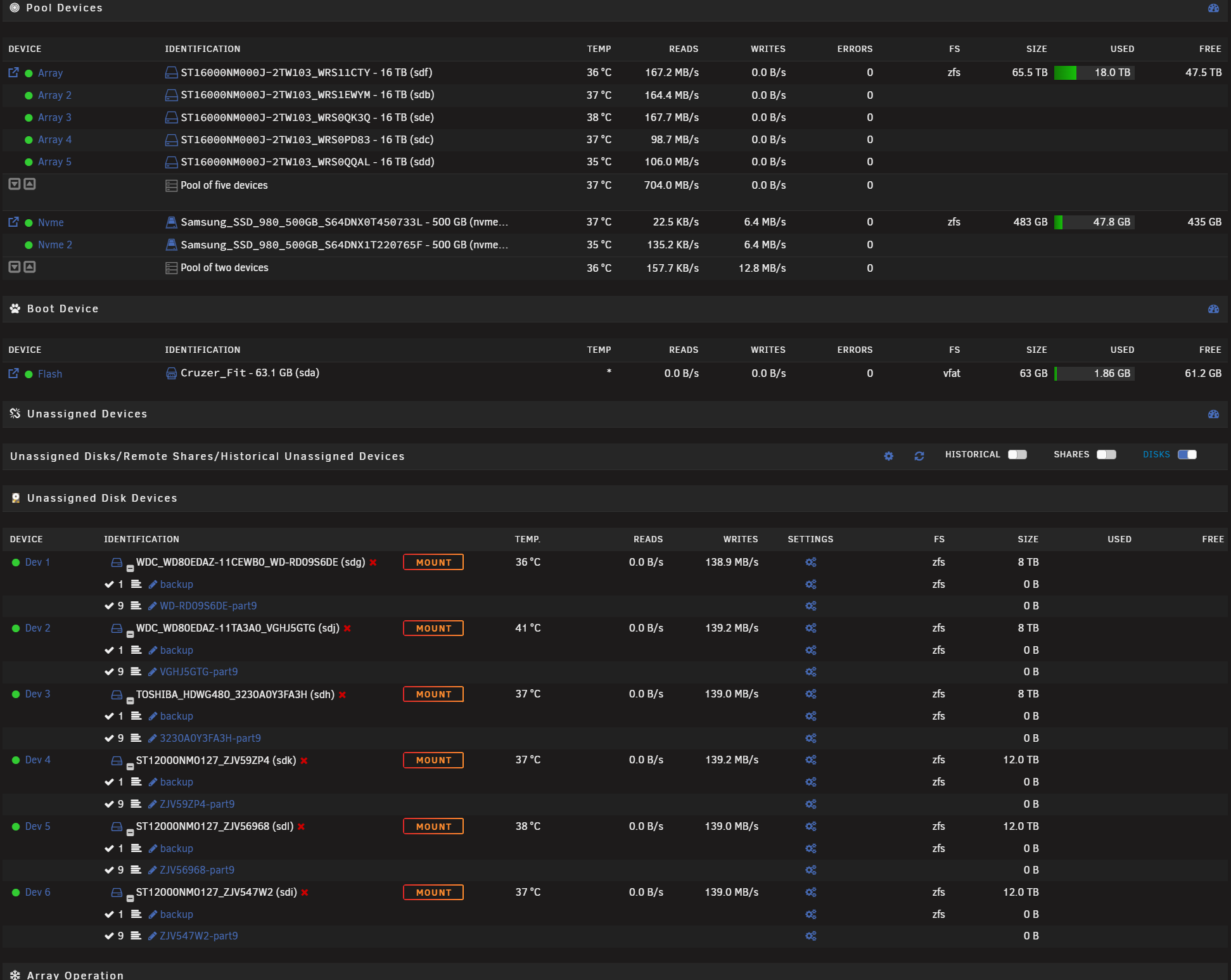

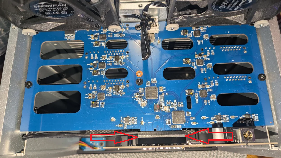

  1. well, finally i located and fixed the issue : It was dirt in the internal conectors in the DaS enclosure , cleaned it with 99% isopropyl alcohol and its working 4 hours ongoing hope it helps someone in the future¡¡ as you can see in the attached image ,all six drives are detected and working ,and not a single error in syslog nostromo-diagnostics-20260321-2200.zip here is a sample picture with the exact zone where the dirt was ,as an advice ,clean every single slot with alcohol, included sata ports/usb C and the board in both sides

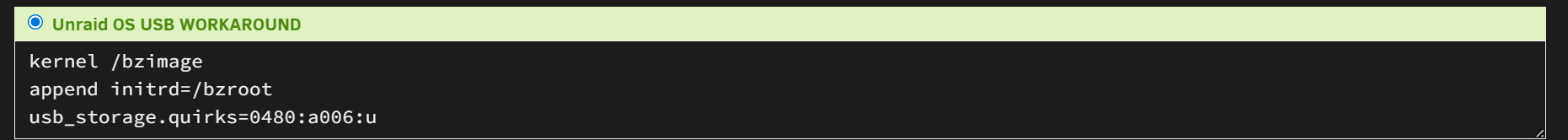

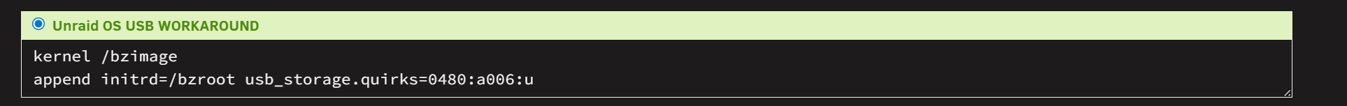

  6. Like this i hope¡¡ will try tonight doing a full backup with rsync , hope it works.If not i will attach the DaS to my main computer which also has 10gbps optical fiber and do the backup the old way ,copy and paste using windows (EWWWWWW)
  7. sigh added the line ,still happening ,the funny thing is that never is the same drive ,nor the same slot. also if i use the DaS in other devices works flawless. could it be some bios setting? im quite lost here. motherboard is an erying 12500h with 32gb ram ,a nvme to sata adapter and i tried 3 usb c cables with the exact same result :(

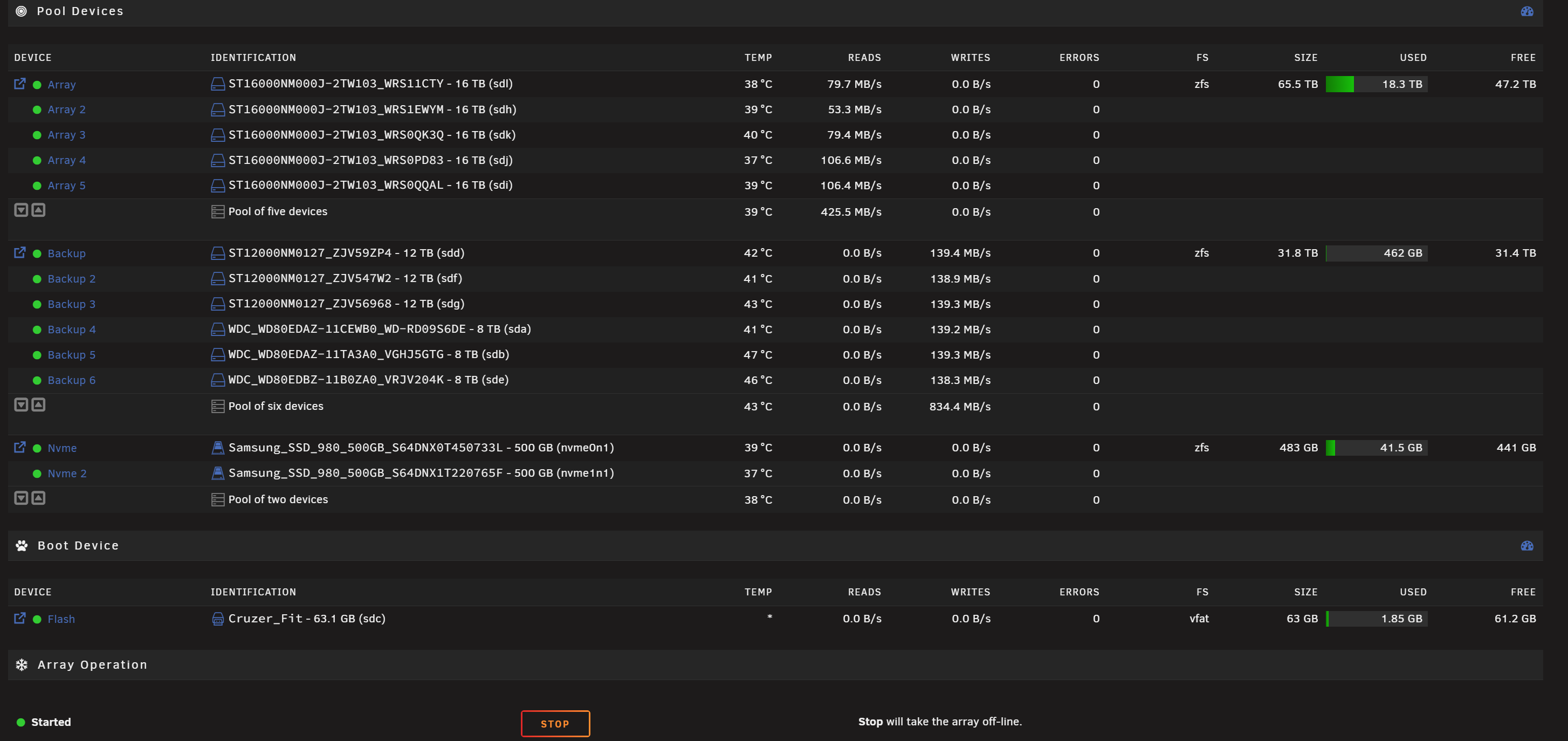

  9. well .it fixed itself ,i really did nothing xD here are the logs and a screenshoot from the backup im currently running: nostromo-diagnostics-20260312-0125.zip seems like the ol "reboot to see if it works" really did hahahaha
