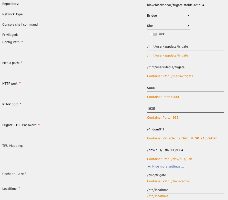

  5. @yayitazale Just installed the getting started parrot model detection routine onto my Mac and it runs fine, so it looks like the TPU hasn't failed. https://coral.ai/docs/accelerator/get-started/
  6. @yayitazale Power shouldn't be an issue, it's been running fine up until now. No other devices on the USB except the OS - and that is direct onto the motherboard. Neither USB2 or USB3 make any difference to this. I guess it's an issue internal to the docker, rather than unRAID -> docker. Thanks for your help. I'll chase Blake via GitHub/HomeAssistant.
  7. @yayitazale Thanks for that. Changing to privileged made no difference, neither did amending the USB path to use the ' /dev/bus/usb' path. The docker still fails with a python error Fatal Python error: Aborted and this is generally proceeded by this line: F :1150] HandleQueuedBulkIn transfer in failed. Unknown: USB transfer error 1 [LibUsbDataInCallback] The system tells me that the TPU has been detected: detector.coral INFO : Starting detection process: 36 frigate.app INFO : Camera processor started for drive: 39 frigate.app INFO : Capture process started for drive: 40 frigate.edgetpu INFO : Attempting to load TPU as usb frigate.edgetpu INFO : TPU found I've also changed the port that the TPU is plugged into and checked that the LED on it is on.
