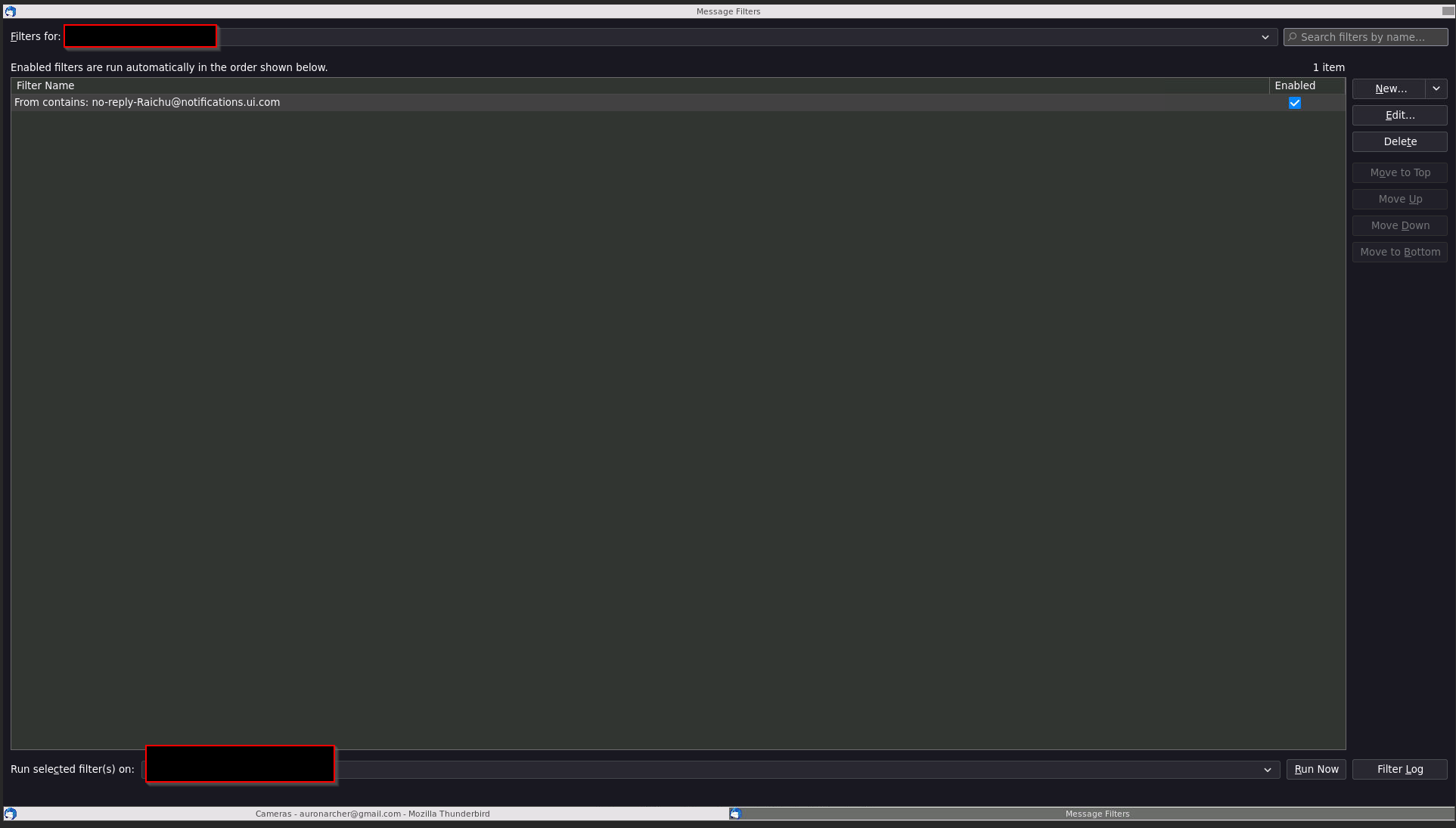

  10. Yes, If I restart the docker from the webgui it drops all filters. This is what the filter screen looks like, I don't see an option within there to exit. Or do you mean from the mail tab file > exit? I can go to File > Quit in the mail tab. Also side note - is there way to close the filters tab at the bottom after opening it? I can't seem to actually get rid of it? May be linked to why it drops when getting rebooted from unraid GUI?
  11. Have been having an issue with Thunderbird dropping all filters that have been set on restart of docker / server etc. Running latest docker image and Unraid 10.2 Has anyone else had anything like this happening? Will try pull logs etc when I get home again
