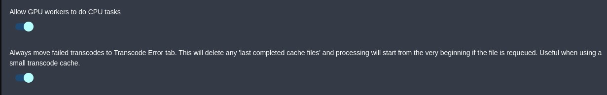

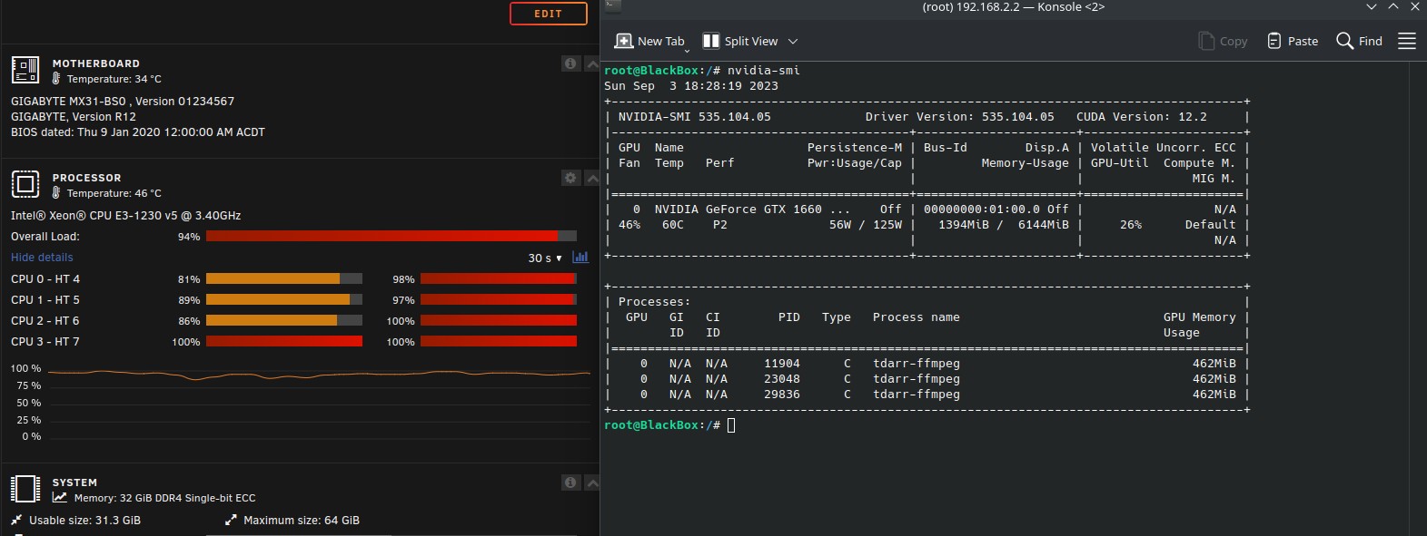

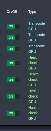

  15. It appears a lot of questions in this thread go unanswered but I will try anyway. I have the tdarr and tdarr_node containers running just fine, libraries added and I can see my GPU doing the transcodes BUT all 8 of my CPU cores are getting maxed out as well. According to spaceinvaders video the impact on the CPU should no where be where it is at.
