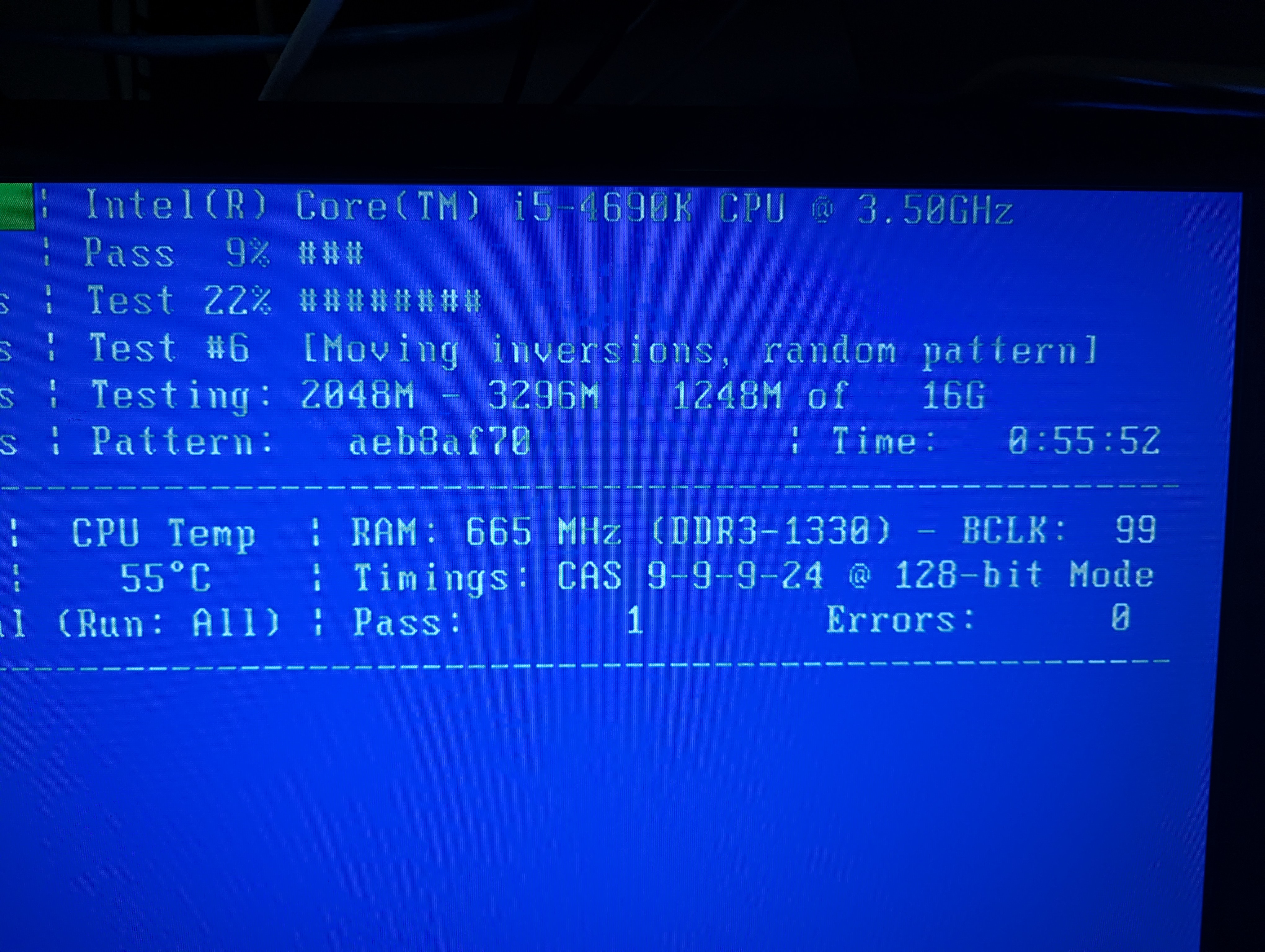

  16. No unclean shutdowns. I will run a memtest shortly and post another update
